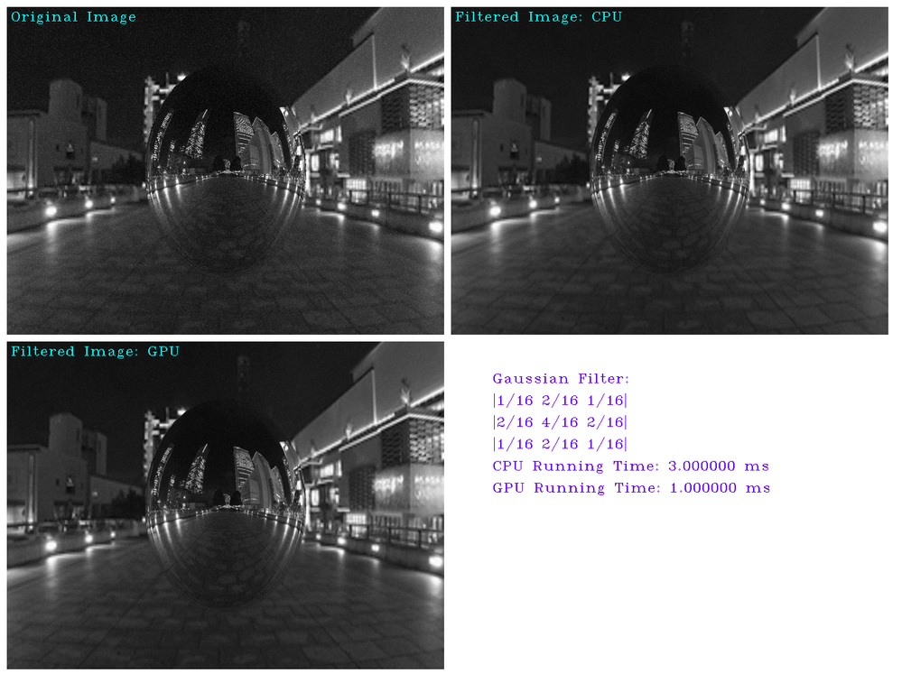

This guide is about how to use EVIS to create user nodes and kernels in OpenVX to implement image processing on NPU(i.MX8MP)/GPU(i.MX8QM). Take gaussian filter as an example. It is tested on i.MX8QM and i.MX8MP.

Exercise
The example is attached. You can build and test it on i.MX8QM or i.MX8MP.
Results on i.MX8QM:
