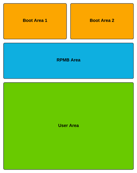

The default partition configuration for an eMMC device is as follows:
Where:
- Boot areas are used for bootloader and environment configurations.
- Replay-protected memory-block area (RPMB) is used to store secure data.
- User area used for application data such as file system, usually divided in two or more partitions.

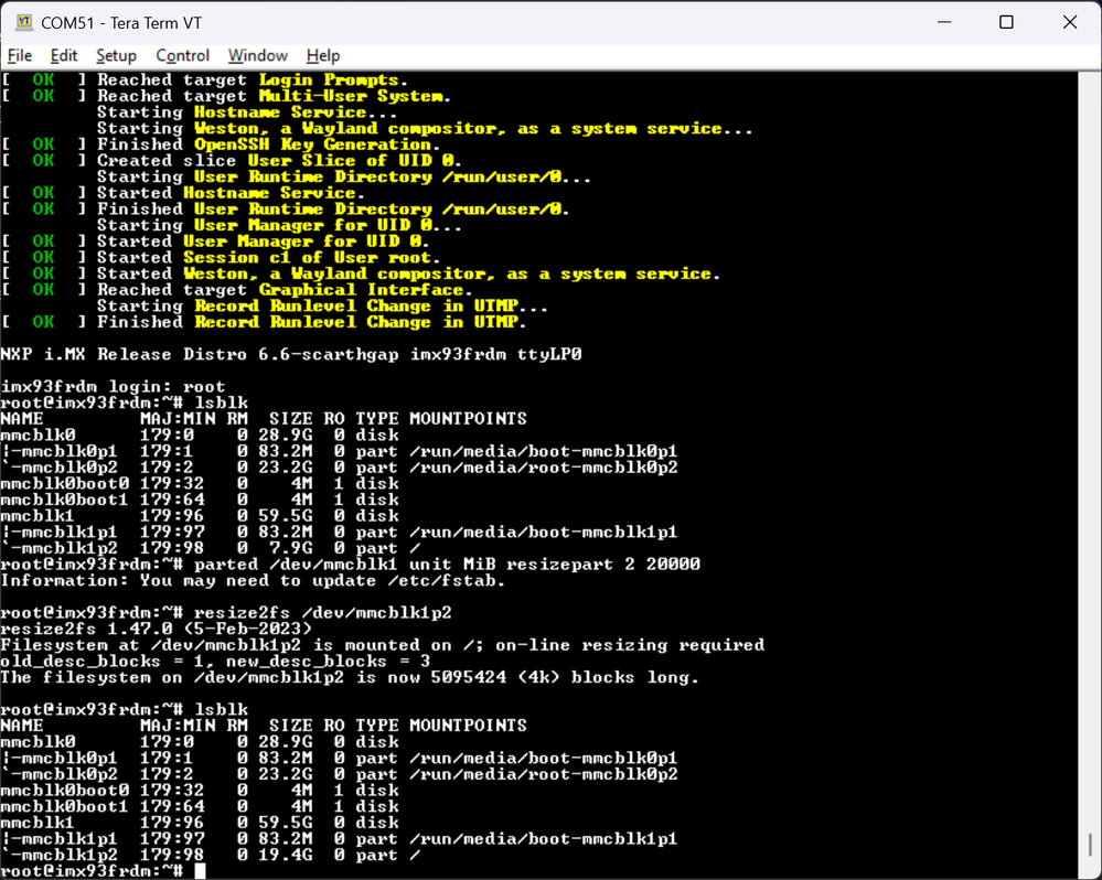

Once the image is flashed into the Micro SD, we need to copy the necessary files such as bootloader and image. By default, our BSP has a User Area space of <>GB and we need to increase it to save the bootloader and the image, here the steps:
Verify the device and partition numeration:
lsblk
The command to increase the size of the partition is the next:
parted /dev/<storage unit> unit MiB resizepart <partition> <size in bytes>
And the command to apply the changes is:
resize2fs /dev/<storage and partition unit>
 In this case, the device and partition we need to change is mmcblk0p2 so, the command is as follows:
parted /dev/mmcblk0 unit MiB resizepart 2 10000
I increased the partition size by 10000 MB; this will be enough to store the required files.
And now, we need to apply the changes:
resize2fs /dev/mmcblk0p2
In the board will look like this:

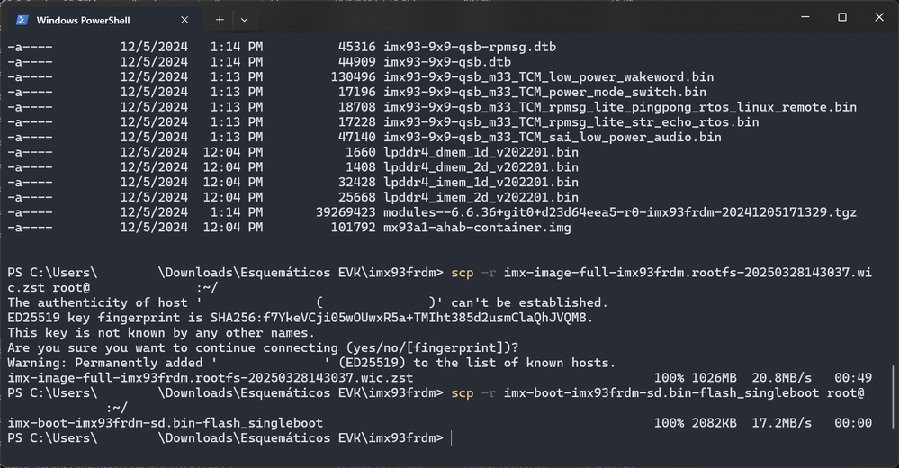

Now, let's copy the bootloader and root file system in SD. In this post we will use SCP:

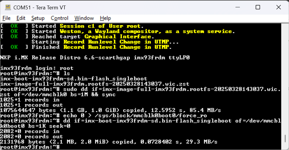

Now, we need to boot from SD card and run the next commands:
As is mentioned in Linux User's guide, we need to flash the .wic image. This contains all the necessary data to flash the entire image but when flashing from SD card to eMMC we need to follow additional steps to unlock the partition used to store the bootloader:
sudo dd if=<image name>.wic of=/dev/sdx bs=1M && sync
Disable write protection:
echo 0 > /sys/block/<storage and partition unit>/force_ro
And flash the bootloader:
dd if=<bootloader> of=/dev/<storage and partition unit> bs=1K seek=0
In the board will look like this:Screenshot 2025-07-07 161944.png
With this process now it is needed to reboot the board, change boot mode switches to boot from eMMC, and the board will boot normally, the user can perform an image flashing to simplify development workflow and also an alternative to update OS without external host dependencies.
