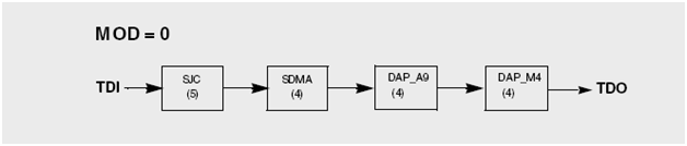

Both A9 core and M4 core have their own DAP, all the resources in its platform
will be accessed through its own DAP.
JTAG Chain Configuration:
− SJC, IR Length = 5, same as i.MX 6Solo;
− SDMA, IR Length = 5, same as i.MX 6Solo;
− DAP for A9, IR Length = 4, same as i.MX 6Solo;
− DAP for M4, IR Length = 4, new in i.MX 6SoloX.
It is needed to use the recent RVICE firmware, which may be found in ARM DS5 Community Edition.
http://ds.arm.com/ds-5-community-edition/
After installation, please run “Debug Hardware Update” option of the DS5 and select
the firmware file for “Install Firware Update” menu. In my case :
c:\Program Files\DS-5 v5.21.0\sw\debughw\firmware\ARM-RVI-4.23.0-35-base.rvi
  Finally, RealView configuration looks as below.
Coresight base address Cortex-A9_0 is 0x82150000.
The Cortex-A9 always boots as the primary core and is responsible for launching the Cortex-M4.
