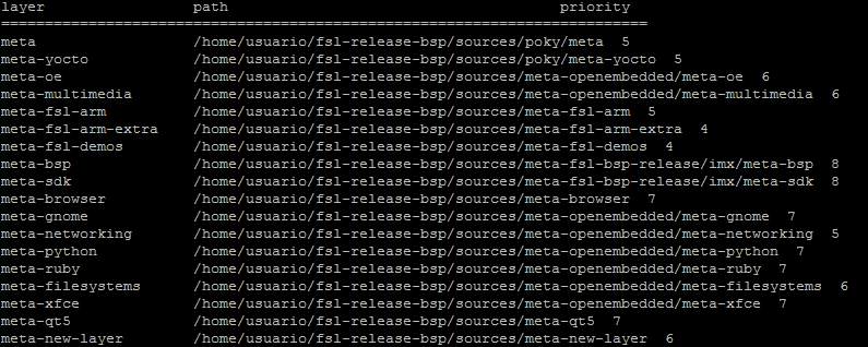

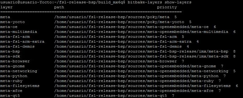

Once your environment is setup you can see the layers that compose the BSP using the command:
bitbake-layers show-layers
The layers that constitute out BSP will be displayed along with the path and priority of each.
Layer Priority: Each layer has a priority, which is used by bitbake to decide which layer takes precedence if there are recipe files with the same name in multiple layers. A higher numeric value represents a higher priority.

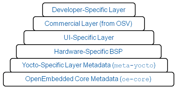

We can see that the poky and open embedded layers have a lower priority than those than the BSP and SDK layers as the later sit on top of the former. The general layout of a BSP is shown on the image below.

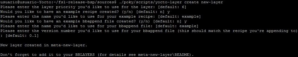

cd <BSP_DIR>/sources
./poky/scripts/yocto-layer create <NEW_LAYER_NAME>
We’ll name the new layer “new-layer” as shown below:
./poky/scripts/yocto-layer create new-layer
We’ll be asked to enter le layer priority, we’ll keep the default 6 but you may want a higher priority depending on your application.
You may opt for an example recipe to be created on your new layer.  We’ll leave this example recipe with the default settings.
You may see the structure of the new layer by using the following command:
tree -L 4 ./meta-new-layer

After doing so we’ll see that our layer is now listed when we run show-layers in bitbake-layers.
