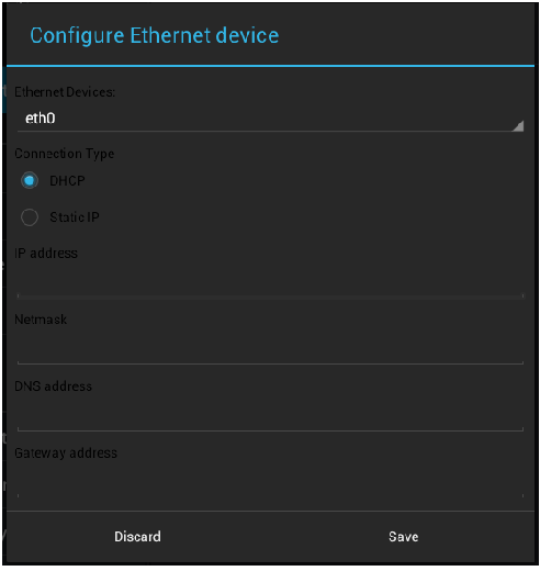

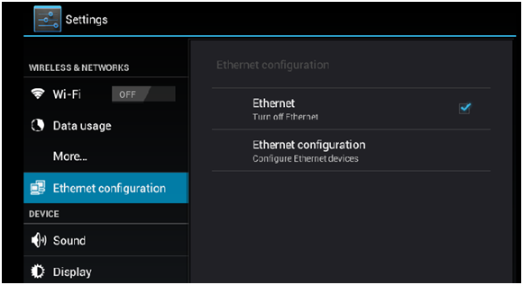

2.  New feature detail
After applying the above patches, you will get the following features:

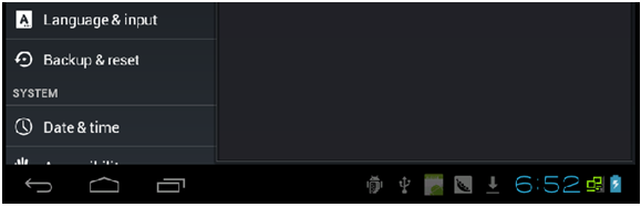

  • Icon for Ethernet connection status. If on, a green icon will appear in status bar; If off,no icon will appear.
  • Add “Ethernet configuration” UI.  Choose box is designed for turn on or off Ethernet.
  • Only Ethernet is turned on, Ethernet configuration can be configured static IP.

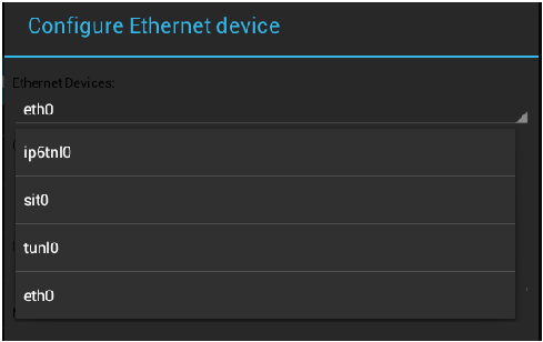

  • First boot, Ethernet device default may not be eth0. So change it from the device list.
Use imx6-ics-ethernet-v3.zip. It has updated and fixed the following issues compared with the previous two versions:
1. fix static IP not work issue.
2. fix dns using default 8.8.8.8 issue.
3. eth0 is the default interface, no longer need to choose it from the list.
4. dhcp is default mode. and if you are using static IP. After reboot, it will restore to dhcp again.
5. no need to edit dns again.
