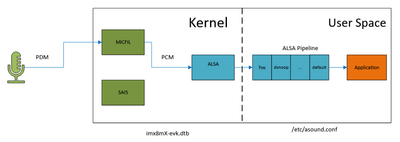

When using PDM Microphones the default data flows is as shown in figure 1. Where the data is capture in the MICFIL peripheral and when it get to the Sound Drivers the data is already converted to PCM, so from the Kernel perspective the data is treaty as PCM values and the conversion from PDM to PCM is done under the hardware.

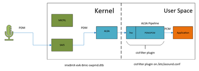

However, with the changes we made earlier on the device tree and adding the plugin on /etc/asound.conf the data flows is as follow:
Where the conversion from PDM to PCM is done just before giving the buffer to the application layer; Thus, conversion is made on User Space and the kernel is aware data have a PDM format. Another difference you can see is that MICFIL is disable and instead the datalines are controlled by SAI5. This is true for i.MX8MM, i.MX8MN, and i.MX8MP.
Although for the application is a transparent change the truth is that the entire pipeline change, so please be aware of how the data is flowing to your application.
