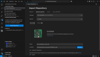

Ensure MCUXpresso for VS Code is properly installed.
Import the iMX8MM-EVK SDK

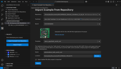

Import "hello world" example

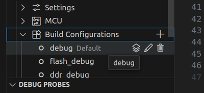

Ensure that we are compiling a debug binary
Build Project

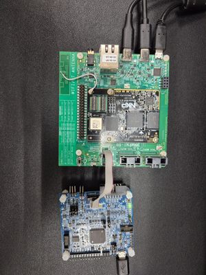

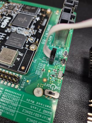

Connect MCU-LINK Pro to the Target
IMX8MM-EVK Debug connection:

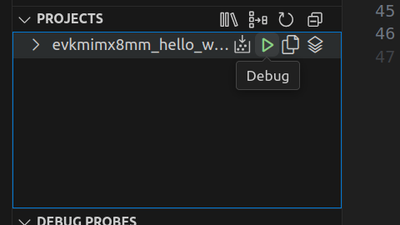

Once the M core is launched, you can start your debug session in VS Code using MCUXpresso:
 With the MCU-LINK Pro configured, the IMX8MM-EVK, and the binary successfully flashed and executed, you are now ready to debug applications on the M core using MCUXpresso and VS Code. This setup enables a reliable development workflow for i.MX8MM based projects.
