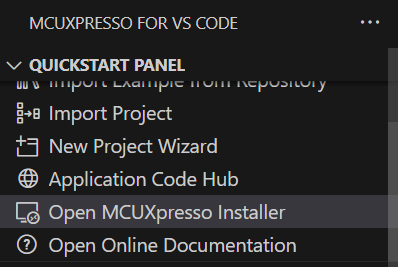

Install Required Tools
Install the MCUXpresso IDE, or use the MCUXpresso Installer for VS Code to install the necessary software tools.

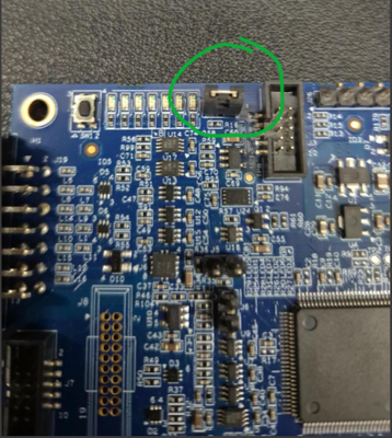

Set Jumper and Connect
Place a jumper on J4 and connect the MCU-LINK PRO to the host PC via USB.

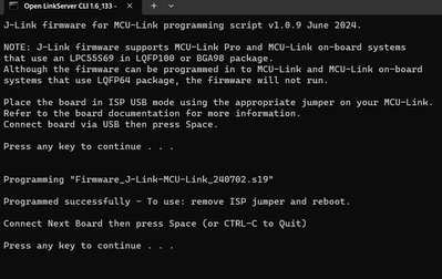

Run the Update Script
Execute the following commands in the terminal:
$ cd MCU-LINK_installer
$ scripts\program_JLINK.cmd
Start Firmware Flash
Once the MCU-LINK PRO is detected, press any key to flash the Segger firmware.
Finalize Update
After a successful update, remove the jumper from J4, disconnect and reconnect the MCU-LINK PRO

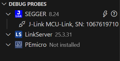

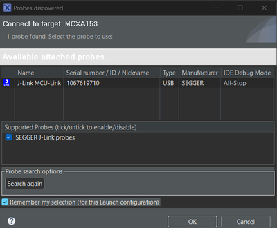

Verify Installation
You can confirm that the debug probe is recognized using MCUXpresso IDE, or MCUXpresso for VS Code
