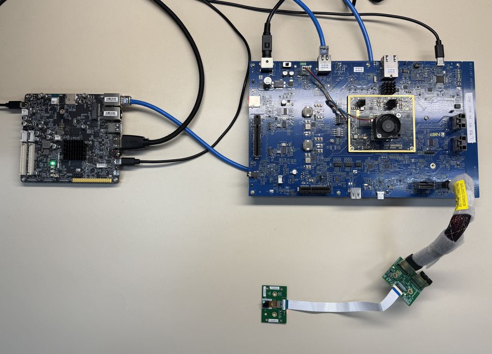

1. Hardware Setup.

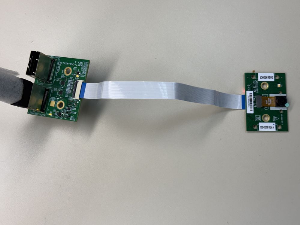

  • iMX95 19x19 EVK. Power supply connected to J5, USB type-C debug cable to J31, AP1302 XRPI-CAM-MINISAS to J13, Ethernet cable to J11.
  • FRDM-IMX8MPLUS. Power supply connected to J2, USB type-C debug cable to J19, HDMI cable to J16, Ethernet cable to J5.
  • Ethernet cables must be connected to network router or switch that can assign them IP.

Camera setup is done as follows

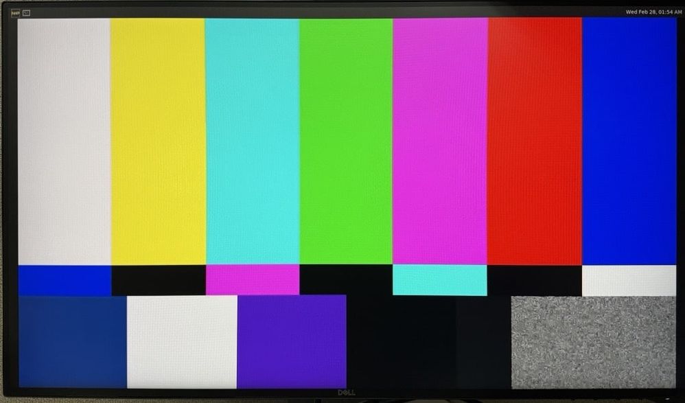

4. Stream video test.
SMPTE Color Bars will be streamed as part of the video test. Video streaming is achieved using test-launch tool, it supports gstreamer pipelines between (" - "), notice that inserts spaces and requires a stream name.
root@server $ ./test-launch "( videotestsrc ! v4l2h264enc ! rtph264pay name=pay0 pt=96 )"
root@client $ gst-launch-1.0 playbin uri=rtsp://$SERVERIP:8554/test
