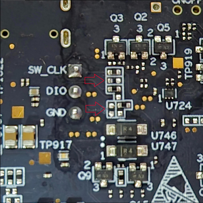

Rework the FRDM-IMX93 Board
The FRDM-IMX93 uses UART5 (shared with the BT module) for debug pins, which causes conflicts. To enable reliable debugging, remove the following resistors:
  • R3017
  • R3018
Note: After this modification, the Bluetooth module will no longer function under Linux.
Schematic:
FRDM BOARD:
Note: After this rework we can't use the Bluetooth module in Linux

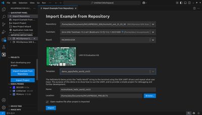

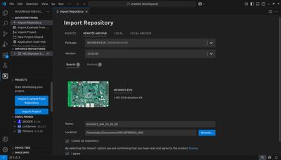

Compile the Binary for the M Core
Ensure MCUXpresso for VS Code is properly installed.
Import the iMX93-EVK SDK
Import "hello world" example

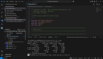

Ensure that we are compiling a debug binary
Build Project

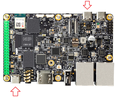

Connect the FRDM Board to your Host PC via USB

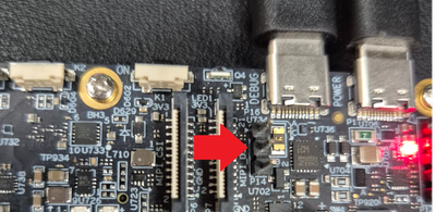

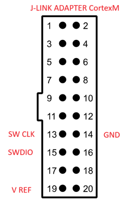

Connect MCU-LINK Pro to the Target
To set up debugging, connect the FRDM-IMX93 board to your host computer using the MCU-LINK Pro and the J-LINK Adapter for Cortex-M.
FRDM-IMX93 Debug connector:
Required Connections
Use the following pin mapping between the J-LINK Adapter and the FRDM-IMX93 debug connector:
J-LINK ADAPTER        -->         FRMD-IMX93
 V REF        -->      3.3v(RPI Connector pin 1 )
 SWDIO        -->      SWDIO (P14 pin 2)
 SWCLK        -->      SWCLK (P14 pin 1)
 GND        -->      GND (P14 pin 3)
Make sure all connections are secure before powering on the board.

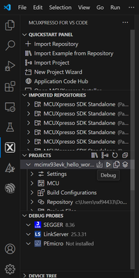

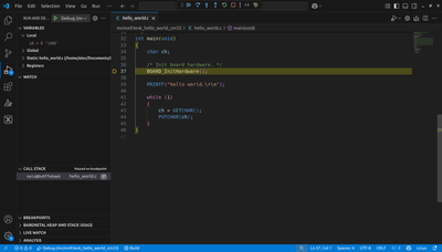

Start the Debug Session
Once the M core is launched, you can start your debug session in VS Code using MCUXpresso:
With the MCU-LINK Pro configured, the FRDM-IMX93 reworked, and the binary successfully flashed and executed, you are now ready to debug applications on the M core using MCUXpresso and VS Code. This setup enables a reliable development workflow for i.MX93-based projects.
