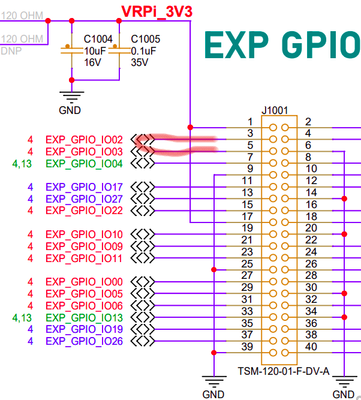

  • Jumper cable to connect GPIO2_IO02 with GPIO2_IO03

On this example, we will take the i.MX93EVK board. The GPIO2_IO02 will be configured as an output and the GPIO2_IO03 will be configured as an input with Rising edge IRQ.
On each GPIO2_IO02 Rising edge, the software will detect an IRQ.

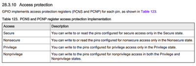

As we can see, we need set the GPIO2 PCNS register to 0x00:
Pin Control Nonsecure (PCNS)
Configures secure or nonsecure access protection for each pin. You can write to this register only in the Secure-Privilege state if it is not locked (LOCK[PCNS] = 0).

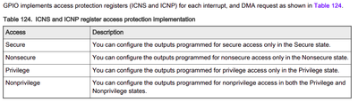

Also the ICNS register to 0x00.
Interrupt Control Nonsecure (ICNS)
Configures secure and nonsecure access protection for each interrupt, or DMA request. You can update this register only in the Secure-Privilege state if it is not locked (LOCK[ICNS] = 0).
Now, we can compile and run the example. On each GPIO2_IO02 Rising edge, the CM33 will detect an IRQ in GPIO2_IO03 (short those pads as showed in the image at first of the post).
