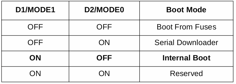

1.- Set SW602 Boot mode pin settings to Serial Downloader mode
2.-Connect JTAG debug probe and turn on the board

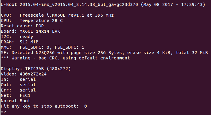

4.- Load u-boot.srec to DRAM and start executing it
The srec is being used in this case because it contains the addresses where the binary needs to be loaded and the entry point for the application is automatically recognised and set by Lauterbach. To load it simply issue 'data.load.S3record u-boot.srec' and then click on go to let it run.
You should now be able to see the output from u-boot on the console hit any key on the console to stop the boot process.

On u-boot execute the 'sf probe' command (sf stands for Serial Flash) to detect the memory.
You should see an output like the following:
=> sf probe
SF: Detected N25Q256 with page size 256 Bytes, erase size 4 KiB, total 32 MiB

7.- Now we can end our debug session and turn off our board
Set SW602 to Internal boot mode (ON/OFF) and SW601 to select boot from QuadSPI (all OFF)
Turn on the board again and you should be able to see u-boot's output on your terminal.
