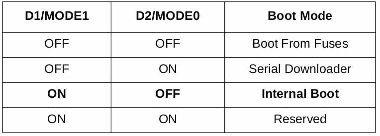

1.- Set SW602 Boot mode pin settings to Serial Downloader mode
2.-Connect JTAG debug probe and turn on the board

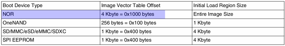

5.- Load QuadSPI configuration to DRAM and flash it to the memory
The Boot ROM on the i.MX6UL requires the configuration data for the QuadSPI memory to be stored at address 0x400 of the QuadSPI memory, the length of this configuration data is 512 bytes. Attached is a configuration binary that can be used for the NOR flash memory used in the i.MX6UL EVK. For more details on the configuration parameters please refer to chapter '8.6.3 QuadSPI Configuration Parameters' of the i.MX6UL Reference Manual.

6.- Load u-boot.imx to DRAM and download it to memory.
We will follow the same procedure to download the u-boot image to the memory.
Stop execution on Lauterbach and load u-boot.imx to DRAM using 'data.load.binary u-boot_SPI.imx 0x90000000' and resume execution (u-boot.imx contains the IVT header which basically stores all the information the device needs to boot u-boot.bin and u-boot.imx).
The boot ROM expects to find the IVT header at address 0x1000 of the SPI NOR Flash memory.
We will load u-boot.imx to this address by issuing 'sf update 0x90000000 0x1000 0x57830'(the size of u-boot.imx is 358448 bytes) this will erase and write the memory.
=> sf update 0x90000000 0x1000 0x57830
358448 bytes written, 0 bytes skipped in 23.741s, speed 15458 B/s

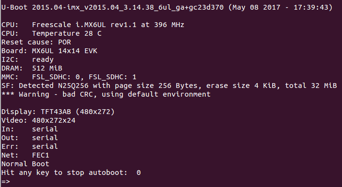

7.- Now we can end our debug session and turn off our board
Set SW602 to Internal boot mode (ON/OFF) and SW601 to select boot from QuadSPI (all OFF)
Turn on the board again and you should be able to see u-boot's output on your terminal.

Hi DJ Regan,
The .cfg file will be located under your tmp/work/... folder after triggering the yocto build, you should be able to use those files. Also please note that the offset for QSPI is 0x1000 not 0x400.
