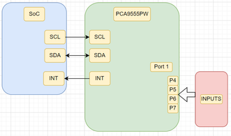

Useful information about push buttons.
Physical level.
     When there is a change of voltage level on P0-P7 pins, PCA9555PW will generate interrupt on INT pin. The driver (running on SoC) can read the status of P0-P7 pins via I2C (SCL/SDA pins) and generate separate interrupts for each of P0-P7 pins. This is why this driver acts as interrupt controller.

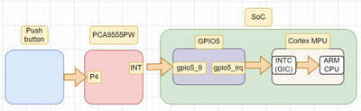

Consider next configuration:
     One push button changes level on P4 pin, tempting PCA9555PW to generate interrupt. Interrupt from PCA9555PW is connected to GPIO5 IP-core (inside of SoC), and it uses line #9 of that GPIO5 module to notify CPU about interrupt. So we can say that PCA9555PW is cascaded to GPIO5 controller. GPIO5 also acts as interrupt controller, and it's cascaded to GIC interrupt controller.
