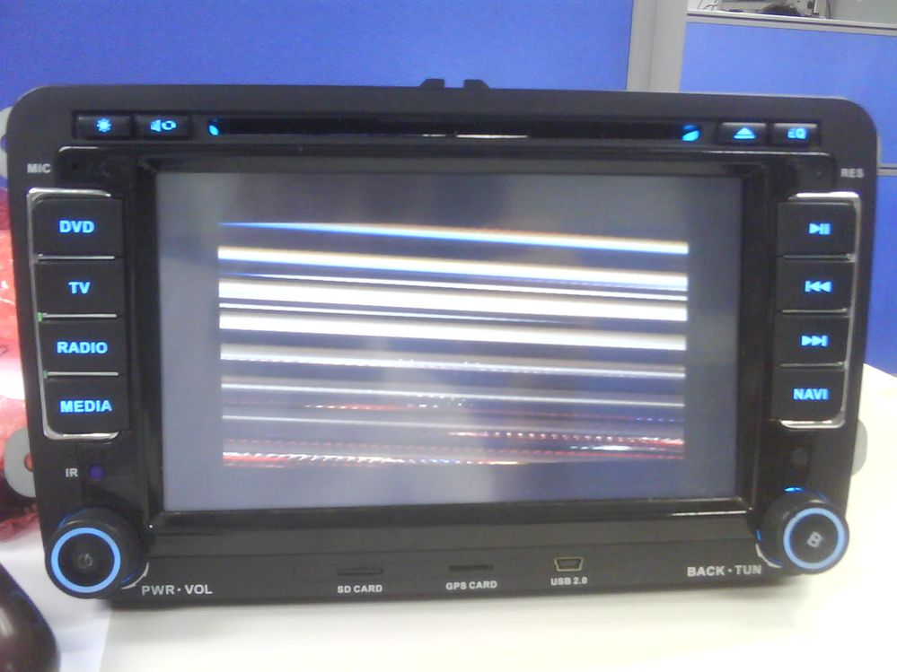

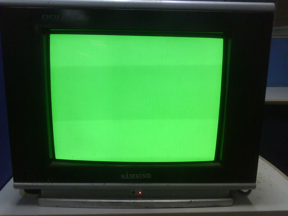

Dear Carl,
Our application is same as yours, but a little different.
LCD 800 X 480
TVE  TV-NTSC
I followed the user guide to modify the init.rc and complie and replace the files: overlay.imx5x.so, gralloc.imx5x.so.
The result is LCD display not normal, TVE is green.
Uboot cmd:
console=ttymxc0,115200 init=/init quiet lpj=4997120 pmem=32M,64M fbmem=10M gpu_memory=96M vmalloc=512M video=mxcdi1fb:YUV444,TV-NTSC tve androidboot.console=ttymxc0 di0_primary video=mxcdi0fb:RGB24,CLAA-WVGA

hi Terry,
The patch only works for HDMI output.
Could you try the following modification with an extra property to rollback TV conf to original BSP?
diff --git a/libgralloc/framebuffer.cpp b/libgralloc/framebuffer.cpp
index e2f19e2..f9ab189 100755
--- a/libgralloc/framebuffer.cpp
+++ b/libgralloc/framebuffer.cpp
@@ -380,7 +380,7 @@ static void setOverlayOutput(fb_context_t* dev)
    char value[PROPERTY_VALUE_MAX];
    //Make the overlay to use FB1 for output
    if(dev->sec_disp_connected&&dev->to_disable_overlay){
-        property_get("rw.DUAL_VIDEO_SIN_UI", value, "0");
+        property_get("rw.DUAL_VIDEO_FOR_HDMI", value, "0");
         if (!strcmp(value, "1")) {
                 property_set("sys.VIDEO_TVOUT_DISPLAY", "0");
                 dev->to_tvout_display = 0;
Dear Max,
Tested, but TVE output green, and it has picture sometime. But LCD doesn't have output.
Terry
hi Terry,
Can I know if the TVE feature is normal on your board based on original BSP?
Max
Dear Max,
The original BSP can output normal TVE NTSC.
Terry
发件人: MaxTsai [email protected]
发送时间: 2013年6月24日 10:12
收件人: Tan, Terry
主题: Re: https://community.nxp.com/community/imx - Dual video with single UI on i.MX53 SMD with Android R10.4
new comment by MaxTsai<https://community.freescale.com/people/MaxTsai> View all comments on this document<https://community.freescale.com/docs/DOC-94879#comment-5071>
hi Terry,
ok. I have no board with TVOUT, but please let me prepare the environment for TVOUT & LCD. I will update later.
Max
Dear Alex,
I.MX53 QSB has both VGA and LCD output.
You can get the TVE from VGA port.
Terry
发送时间: 2013年6月24日 11:09
收件人: Tan, Terry
new comment by MaxTsai<https://community.freescale.com/people/MaxTsai> View all comments on this document<https://community.freescale.com/docs/DOC-94879#comment-5073>
hi Terry,
We have a workaround to force dual video of MX53QSD work for legacy TVout.
You may reach Carl for the workaround.
