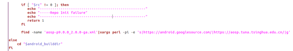

4、Modifying android setup script and Running it
Open ~/imx-p9.0.0_2.0.0-ga/imx_android_setup.sh and add a line like below:
if [ "$rc" != 0 ]; then
echo "---------------------------------------------------"
echo "-----Repo Init failure"
return 1
fi
find -name 'aosp-p9.0.0_2.0.0-ga.xml'| \
xargs perl -pi -e 's|https://android.googlesource.com/|https://aosp.tuna.tsinghua.edu.cn/|g'
fi
Then save it and exit.

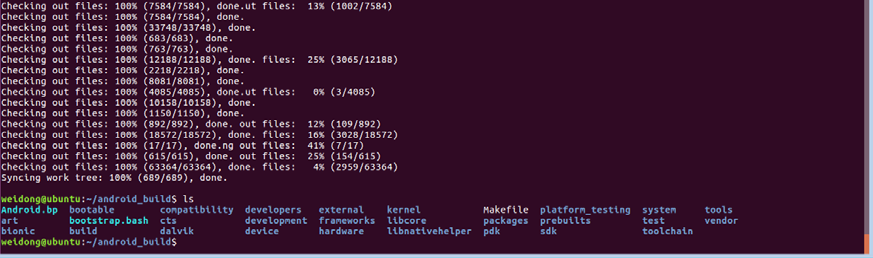

# cd ~/
# source ~/imx-p9.0.0_2.0.0-ga/imx_android_setup.sh
Then android_build directory is created at ~/

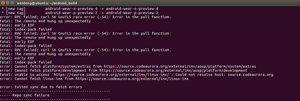

If fetching errors occur, like below, run “repo sync” again.
# repo sync
# export MY_ANDROID=~/android_build
[Note] imx_android_setup.sh will be in charge of downloading all android source

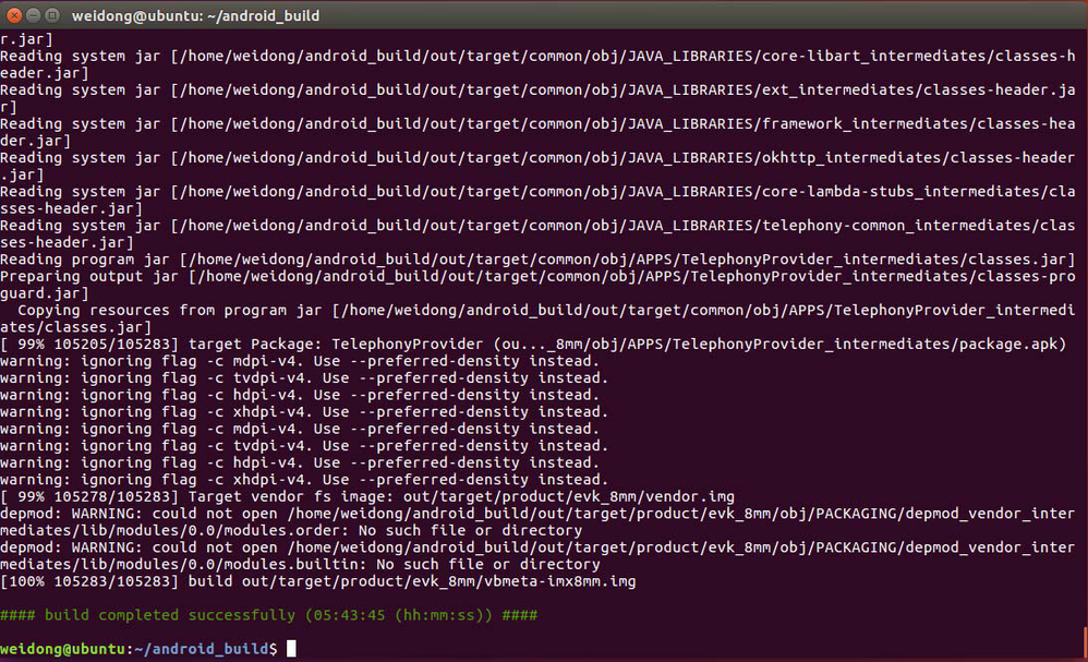

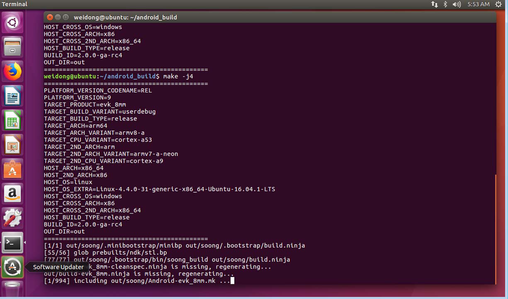

5.Begin to compile android 9.0.0-2.0.0 BSP
$ export ARCH=arm64
$ export CROSS_COMPILE=${MY_ANDROID}/prebuilts/gcc/linuxx86/aarch64/aarch64-linuxandroid-4.9/bin/aarch64-linux-android-
$ cd ~/android_build/vendor
$ cp -r ~/imx-p9.0.0_2.0.0-ga/vendor/* ./
$ source build/envsetup.sh
$ lunch evk_8mm-userdebug
$ make –j4
