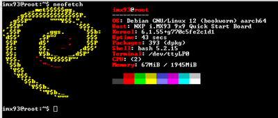

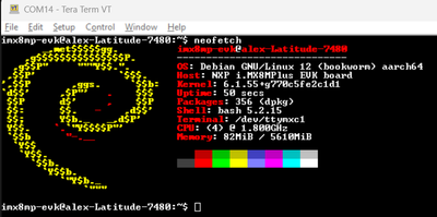

Install Neofetch (Optional)
$ apt install neofetch
Outputs
  • Debian 12 running on i.MX8MP
  • Debian 12 running on i.MX93
