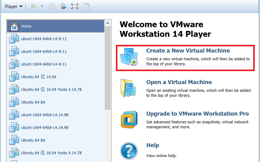

1. Create the VM in VMware Workstation.

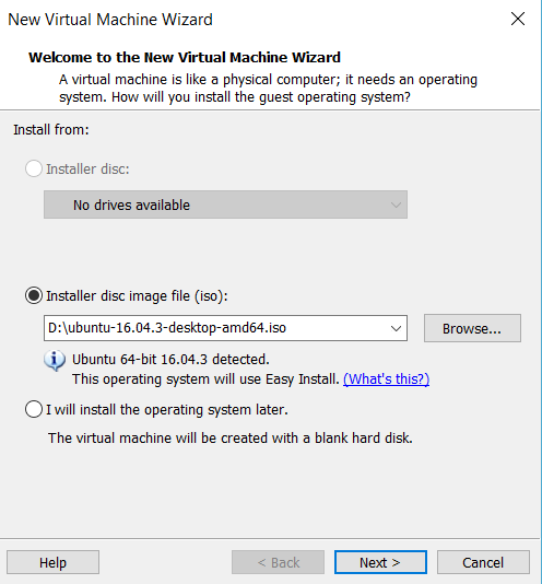

2. Select the .iso file to install the Ubuntu 16.04 in the VM.
