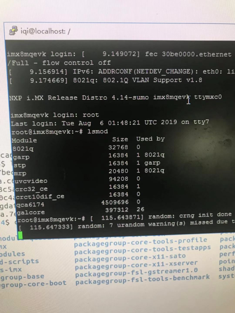

In Ubuntu-i.MX8M.pdf ,I did not build weston in step 7 and I apt-get install lxqt.Use lxqt as the display desktop.I get follow results:
I have successfully loaded the gpu driver,But why no application uses gpu.When I do not use ubuntu filesyste,I get follow results:
have 26 apps uses gpu.
Please help me answer,thanks,have a nice day!
our GPU is support wayland only.
You should try build the desktop with source code and enable xwayland.
how to enable xwayland in lxqt.I can install gnome-wayland only.In lxqt desktopNo xwayland related configuration options.
you can refernce the yocto script to build xwayland.
But I am not sure if you use LXQT could use GPU, The best way,
you should build LXQT source code with our gpu driver instead of apt-get LXQT directly.
