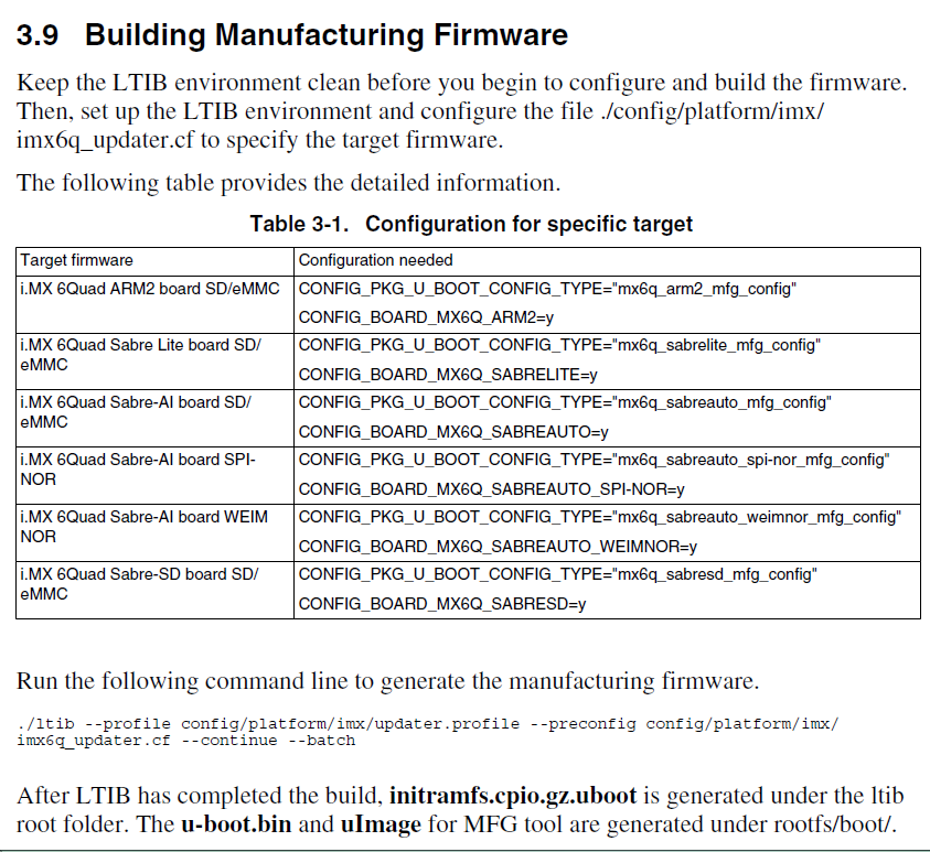

In the old version BSP, take the L3.0.35_4.1.0_130816 version as an example. When finishing porting the BSP for design board.
Run the following command line to generate the manufacturing firmware.
./ltib --profile config/platform/imx/updater.profile --preconfig config/platform/imx/imx6q_updater.cf --continue –batch

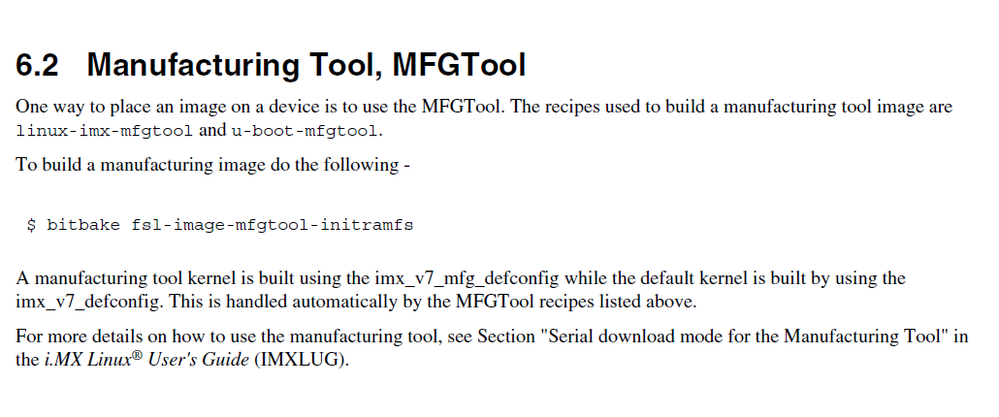

In the newest BSP, for linux BSP in yocto use the command:
$ bitbake fsl-image-mfgtool-initramfs

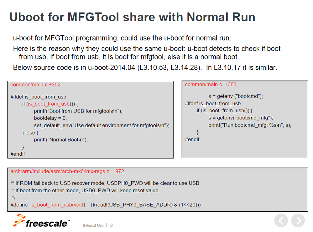

For the newest android BSP, the command” make mx6dl_sabresd_mfg_config” can not use anymore. So how to get the \Profiles\Linux\OS Firmware\firmware\u-boot-imx6dlsabresd_sd.imx?
The easiest way that you can use the u-boot you build for your board, and in the newest BSP, mfgtool can use the same u-boot with the normal u-boot for your board. You do not need to build the u-boot for mfgtool separately. They can use the same one.
