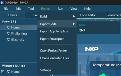

1. Export your project from the folder GUI-Guider-Projects to your Linux PC.
