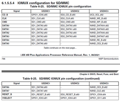

The i.MX8MP there is 3 SDIO interface,and the i.MX8MP has 3 USDHC ports:USDHC1, USDHC2 and USDHC3.
At i MX8MP supports SD/MMC/eSD/eMMC/SDXC, and starts and boots using the USDHC port based on setting of the BOOT_MODE[3:0] pins.

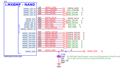

In the reference design, eMMC is connected to USDHC3, and SD card is connected to USDHC2. USDHC3 is used as the eMMC boot device by default on the development board. We can see the detailed definitions of the three USDHC interfaces in the reference manual. Among them, USDHC1 and USDHC3 are 8 bits and support 8-bit data, while USDHC2 only supports 4-bit data.
2.2 Hardware and software design
The hardware design is as shown above. The eMMC is connected to the SD3 interface, and the software is configured in this way by default.

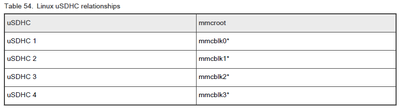

We can see the correspondence between the USDHC interface and the mmc under Linux. The kernel MMC module now uses a fixed mmcblk index for the uSDHC slot. The default BSP is "mmc2=&usdhc3":

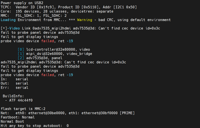

  1. In the design of the MX 8M Plus LPDDR4 EVK development board, by default, the eMMC is connected to the USDHC3, SD3 is used, and mmcblk2 is used in the SD3 slot. When setting the kernel parameters in the u-boot, you can see that:
### select mmc dev 2 (USDHC3) on the i.MX 8M Mini EVK, i.MX 8M Nano EVK, and i.MX 8M Plus EVK:
U-Boot > mmc dev 2 0
For the emmc the related port is :mmcblk2
By default, the flash target is MMC: 2 after the Demo images burning of the development board is started.
