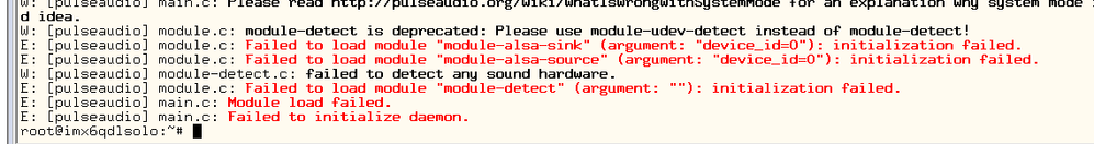

load-module module-alsa-sink device_id=0 tsched=true tsched_buffer_size=1048576 tsched_buffer_watermark=262144
On the system that can automatically detect the alsa cards, the above line #13 should be removed.
Also make sure "auth-anonymous=1" is added to the following line, which can resolve the issue: "Denied access to client with invalid authorization data".
load-module module-native-protocol-unix auth-anonymous=1

Pulseaudio can be started as a daemon or as a system-wide instance. To run PulseAudio in system-wide mode, the program will automatically drop privileges from "root" and change to the "pulse" user and group. In this case, before launching the program, the "pulse" user and group needs to be created on the target system.  In the example below, "/var/run/pulse" is the home directory for "pulse" user.
adduser -h /var/run/pulse pulse
addgroup pulse-access
adduser pulse pulse-access
Because PulseAudio needs to access the sound devices, add the user "pulse" to the "audio" group too.
adduser pulse audio
Starting bluetoothd and pulseaudio:
/usr/libexec/bluetooth/bluetoothd -d &
pulseaudio --system --realtime &
To verify if the pulseaudio has been set up correctly, you can play a local wave file by using the following command. If you can hear the sound, the system should have been configured correctly.
paplay -vvv audio8k16S.wav
