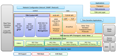

1.2.1.     AVB/TSN
AVB (Audio Video Bridging) is a common name for the set of technical standards which provide improved synchronization, low-latency, and reliability for switched ethernet network. AVB was initially developed by the IEEE Audio Video Bridging task group of the IEEE 802.1 standards committee. In November 2012, AVB group was renamed to TSN (Time-Sensitive Networking) task group to reflect the expanded scope of its work, which is to provide the specifications that will allow time-synchronized low latency streaming services through IEEE 802 networks.
The referring standards shows as follows:
  • TSN protocol additions
    • QoS components supported in HW TSN MAC + SW driver
    • Managed Object components expose i/f to allow support of standardized network config protocols (local & remote)
    • Transport API to allow other transport layer to use TSN QoS
  • Stack extensions to map traffic priority to application task scheduling
    • Real Time, gPTP based, Best Effort

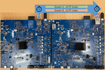

1.2.2.     Demo introduction
The two streams are defined as below to grantee time sensitive (sub-microsecond synchronization), low latency and bandwidth on the ethernet:
  • Stream A: SR class A, AVTP Audio Format, PCM 16-bit sample, 48 kHz, stereo, 12 frames per AVTPDU.
  • Stream B: SR class B, AVTP Compressed Video Format, H.264 profile High, 1920x1080, 30 fps.
The two TSN streams would be allocated into different TC (traffic control) class for egress. Different TC class would be mapped to different hardware queues with specific DMA channel which supported by ENET_OoS IP.

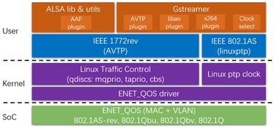

The demos were built by follow blocks:
  • Linux Traffic Control: streams egress control
  • Linux ptp: clock sync in network
  • Libavtp: Time Sensitive Applications AV Transport protocol
  • Gstreamer: avtp plugin uses the libavtp to transmit and receive AVTP audio/video (audio pcm, video h264).

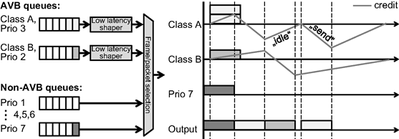

1.2.3.     Traffic control
Multiply queue qdiscs + CBS:
The CBS class is actually handled by hardware IP to select which queue for transmitting.
CBS parameters come straight from the IEEE 802.1Q-2018 specification. They are the following:
  • idleSlope: rate credits are accumulated when queue isn’t transmitting;
  • sendSlope: rate credits are spent when queue is transmitting;
  • hiCredit: maximum amount of credits the queue is allowed to have;
  • loCredit: minimum amount of credits the queue is allowed to have;

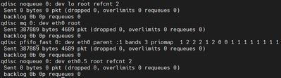

You can also check which qdisc queue is used for AAF by:
$ tc -s qdisc

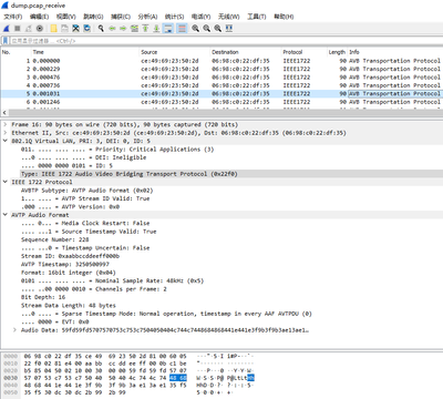

5.  Packet sniffer
Use tcpdump on board to dump the L2 ethernet packet:
$ tcpdump -i eth0 ether proto 0x22f0 -w dump.pcap
The AVTP ether protocol code is 0x22f0 embedded inside the ether frame, or you can use "vlan 5" VLAN id for tcpdump parameters to dump.
Then open this dump.pcap in the windows/Linux PC by the wireshark tool, it will automatically show the protocol inside the package, it can also parser the IEEE1722 (AVTP) CVF/AFF package header as below:
To measure the package latency from transmit port (talker) to receive port (listener), you can use the tcpdump on both end-points. And compare the Epoch Time the packet dumped: "Epoch Time: 1596252905.688243000 seconds". The delta of the epoch time of the same packet is around 100us~500us. This latency actually includes the AF_PACKET clone cost in kernel netfilter, also the tcpdump application schedule latency.
