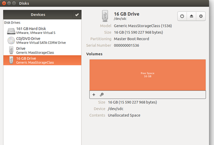

Now  We are going to burn the memory, we need a 16Gb of space:
We need to make sure it is empty

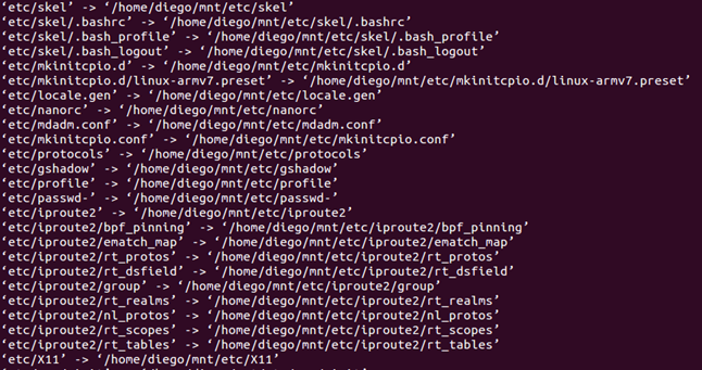

Now we where the kernel and filesystem are and copy all the file in mnt:
$ sudo cp -vr * ~/mnt/
Once it finish we execute
$ sync

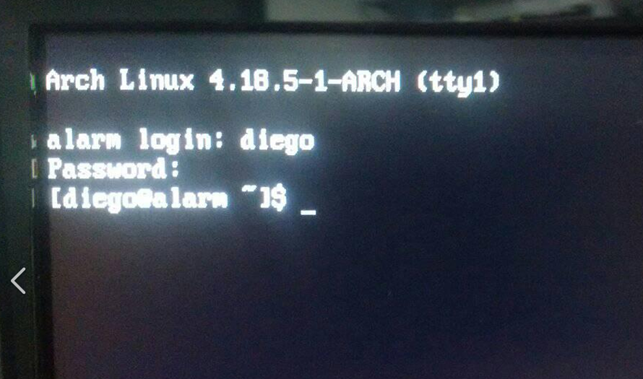

we retire the sd and turn on the board. Now you are on ArchLinux.
user: alarm                  root: Root
Pass: alarm                 pass: root
Now the firts thing we must do it is upgrade the keys:
$ pacman -key --init
$ pacman -key --populate archlinuxarm
$ pacman -Syyuu

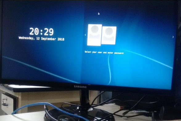

Now we can execute startx and observe the windows of xorg
$ startx
To have a windows gestor:
$ sudo pacman -S sddm
$ sudo pacman -S plasma kde-applications
$ sudo systemctl enable sddm
Reboot and you are ArchLinux graphics windows
