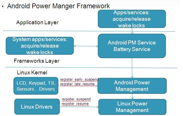

What Power Manager introduced by Android
Early Suspend
   It is allow drivers like LCD, keypad backlight, touch-screen, gsensor, to be notified when user-space writes to /sys/power/request_state to indicate that the user visible sleep state should change. These drivers will act as like Linux stand suspend() to let these devices entry in suspend for better battery life.
Late Resume
   Late resume is matching with early suspend. It will resume the devices suspended during early suspend after the Stand Linux resume finished
Wake Locks
    Wake locks are used by applications, services, kernel drivers to request CPU resources. A locked wakelock, depending on its type, prevents the system from entering suspend or other low-power states. It as a core member in android power management architecture from framework to kernel
