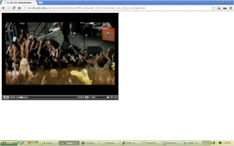

HTML5 Video Web Page
  • <video> element example
<video src="movie.mp4" poster="movie.jpg" controls>
</video>
  • HTML5 video page source example
<html>
          <head>
          </head>
           <body>
                     <video src="http://10.192.225.226/movie.mp4" width="640" height="480"  controls="true">
                     </video>
           </body>
</html>

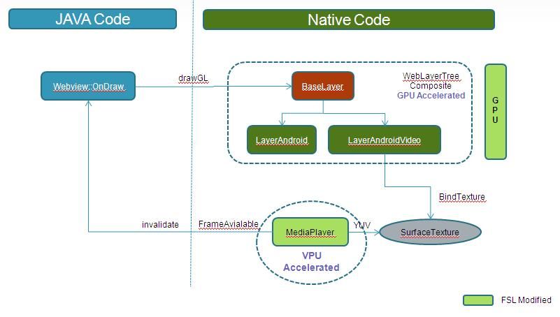

HTML5 Video Rendering Path
Performance Data in i.MX6Q with Android ICS
  • With LVDS display, H264@1080p@20Mbps
    • Can reach 30 fps
  • With HDMI 1080p display, H264@1080p@10Mbps
    • Can reach 25 fps
