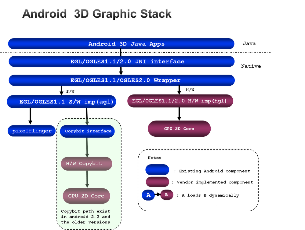

  • All Android 3D apps and games have the following graphic stack:

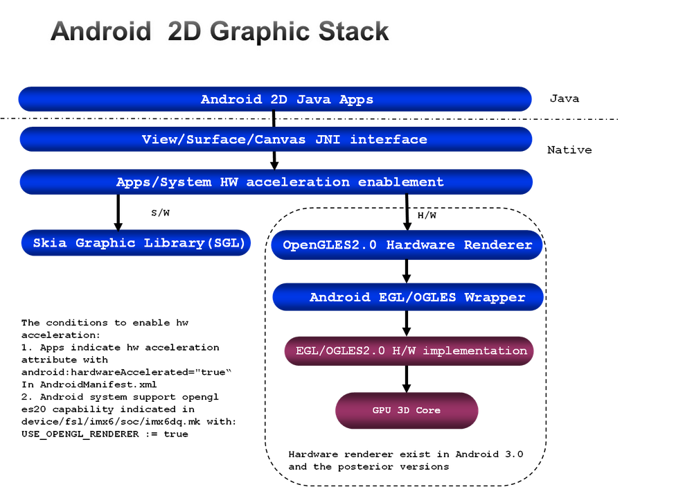

  • Android system UI and all Apps UI follow 2D graphic stack as below, the hardware render will accelerate Android 2D UI with GPU HW OpenGL-ES 2.0 to improve the whole UI performance.
Hardware acceleration can be disabled on i.mx6 in device/fsl/imx6/soc/imx6dq.mk
USE_OPENGL_RENDERER := false
Then rebuild frameworks/base/core/jni, and replace libandroid_runtime.so

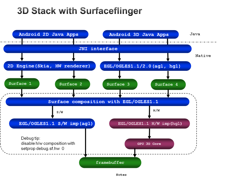

  • Surfaceflinger is responsible of all surface layers composition, and  then generate the framebuffer pixmap for display devices. these graphic surface layers are from 2D/3D apps.

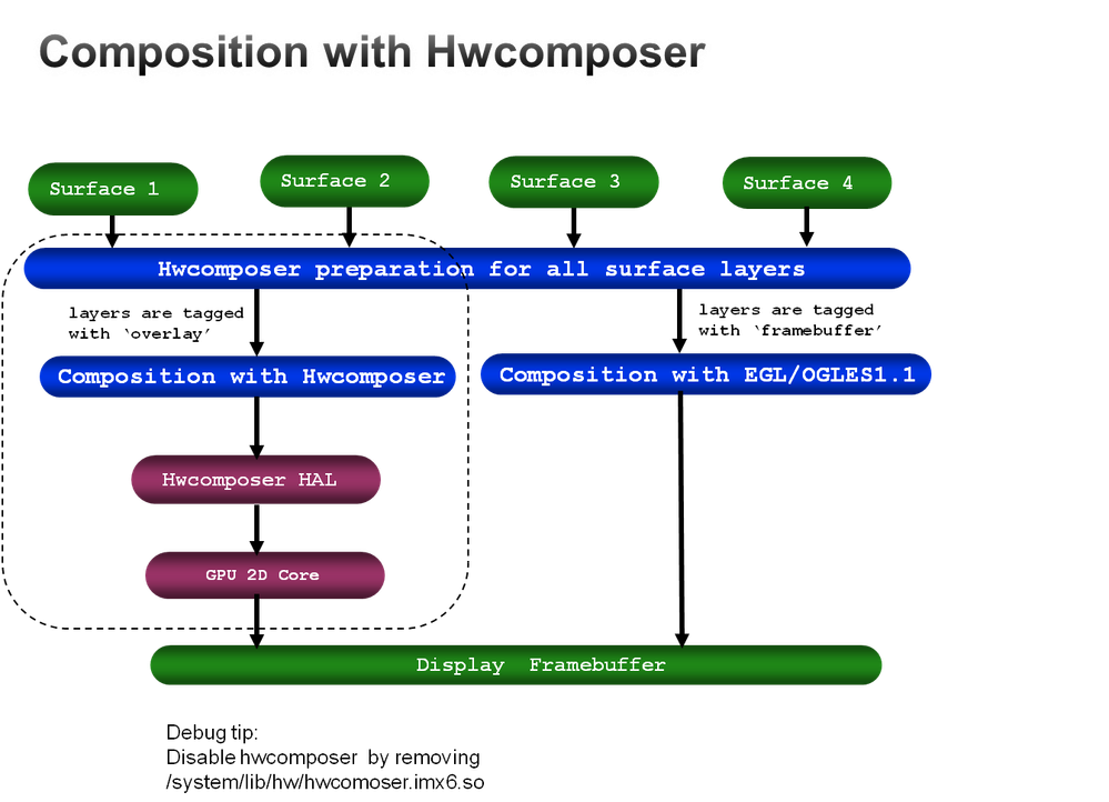

  • Hwcomposer is the alternative module of Surfaceflinger with OpenGL-ES. Hwcomposer is used to combine the specific surface layers supported by specific vendor devices. Freescale i.MX6 devices use GPU 2D to combine most surface layers, and the system power can be reduced with GPU 2D instead of GPU 3D. The typical power saving case is video playback.
Hwcomposer with GPU 2D can offload GPU 3D task when running game and benchmarks, it is proved to improve the overall system performance about 20%.

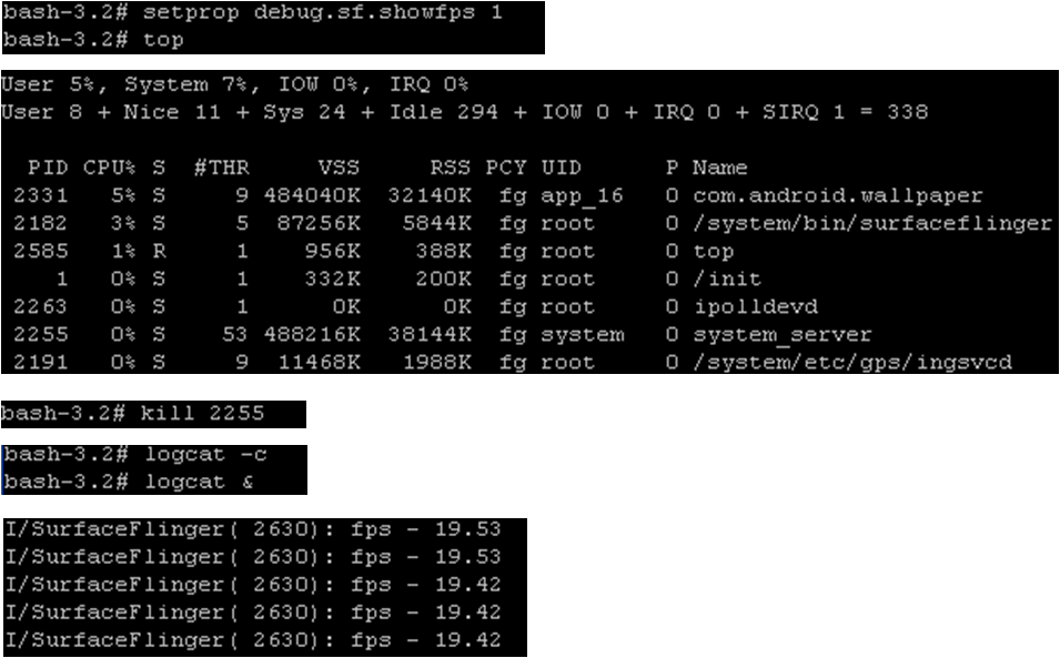

  • Show FPS for Android system performance
For NFS boot you can set “debug.sf.showfps” to 1 in init.freescale.rc (“setprop debug.sf.showfps 1”) and then reboot the system. For SD or EMMC boot, you can issue command “setprop debug.sf.showfps 1” in console, then find system_server thread by top and kill it to reset the system.
