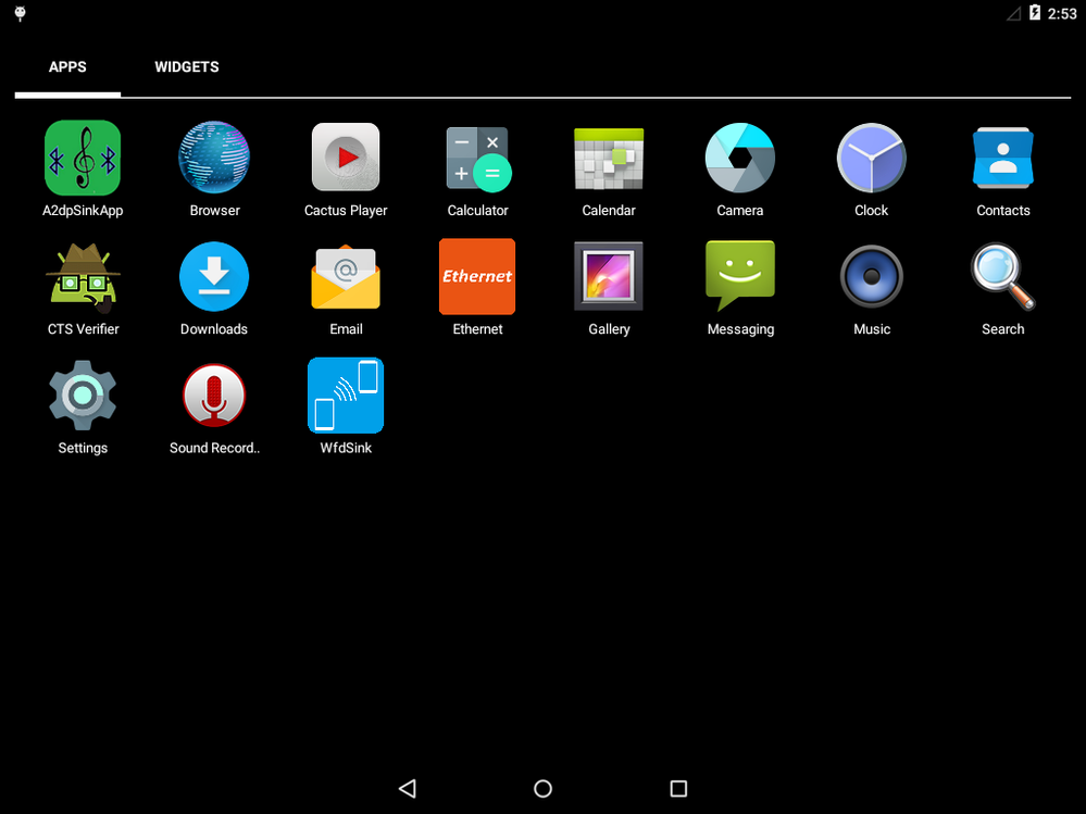

Initialization:
After the setup is done, you should see the application installed:
