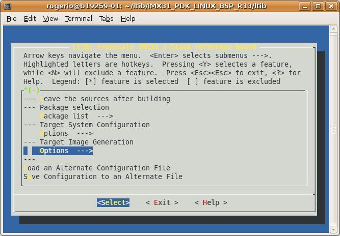

1 - Run LTIB configuration typing:
$./ltib -c
2 - On first page menu, go to "Target Image Generation -> Options" as in the picture below.

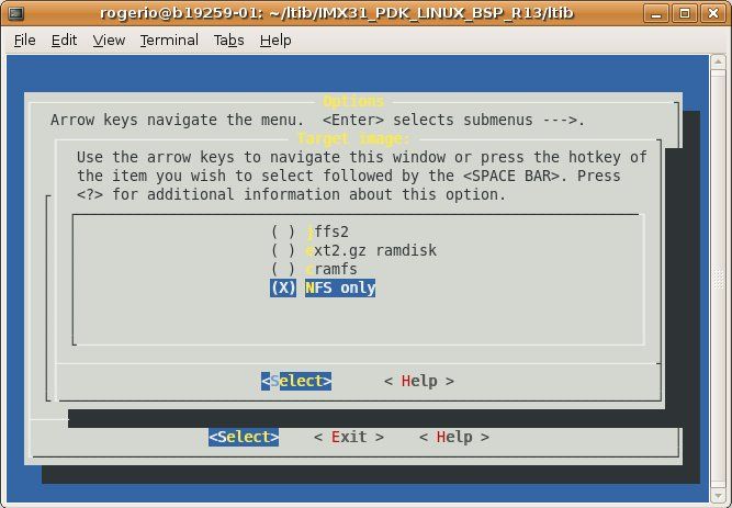

3 - Select the option NFS only and exit LTIB configuration to compile with the new configuration.
4 - LTIB should start new compiling and create a new Linux image on /<ltib instalation folder>/rootfs/boot/zImage
5 - Copy the created image on /<ltib instalation folder>/rootfs/boot/zImage to /tftpboot/zImage
6 - The system is ready to run with NFS. The root file system on target will be located on host on /<ltib instalation folder>/rootfs/
