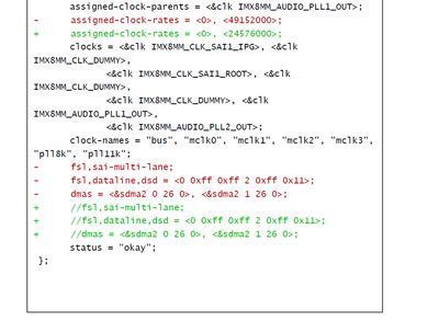

In i.MX8MQ and i.MX8M Mini, the codec used is WM8524, which only supports audio playback. Although 8M Mini does have PDM microphone interface (MICFIL), there is no support for audio record via I2S. This guide will show you how to add audio recording driver in i.MX8MQ/8MM step by step.
Hardware: i.MX8MQ/8MM Evk, I2S output digital microphone
OS: Android/Linux
Kernel version: 4.14.78
For detailed steps, please see attachment.

When I tried to apply the described changes in linux kernel version 4.19.42 on the i.MX8MM I ran into the following problems:
In in imx-micarray.c:
struct imx_priv has no members slots and slot_width
micarray_rates and micarray_channels are not declared anywhere.
Can someone support me with fixing this or provide me with an update?

Sorry for your confusion.
1. You can add  unsigned int clk_frequency; unsigned int slot_width; in imx_priv
2. You can add
+static const u32 micarray_rates[] = {
+ 8000, 16000, 32000,
+ 48000, 96000, 192000,
+ 384000, 768000,
+static const u32 micarray_channels[] = {
+ 1, 2, 4, 6, 8,

I found this document very helpful " Add audio record driver in i.MX8MQ&MM.pdf",
I have similar requirements to support Playback and Capture with WM8524 via SAI1. I have one question, I see in this document you have removed the following fsl,dataline and fsl, sai-multi-lane from the DTS file
so could you help me to understand why we don't need it, for playback and capture?
Thanks in advance.
