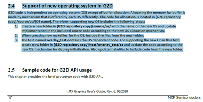

The i.MX Graphics User's Guide, Rev 6, 06/2020 for  Android Q 10.0.0_2.3.0 linux 5.4.24 section 2.4 provide instructions for building the G2D code.
As of now, I only have the libg2d.so binary file, but not the source code.

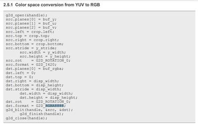

I am wanting to update the library to support colorspace conversion (CSC) from greyscale Y8 / raw8 bit format (true monochrome AND not BAYER) to RGBA8888.
I am specifically wanting to get an updated version of the library to have the following features:

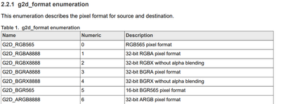

3. Can you please let me know if the latest libg2d supports the G2D pixel format A8 , documented as supported by the hardware in Table 14-3 on page 4326 of the i.MX 8M Mini Applications Processor Reference Manual, Rev. 3, 11/2020 ?
If not, then I'd like to add this support to the library.
4. Is 2D GPU A8 format support implemented in any other linux drivers, board support package, sample code, etc?
5. Can you please let me know if the latest libg2d supports the G2D pixel format "8-bit color index" also shown in the same table of the reference manual?
6. Is 2D GPU "8-bit color index" implemented in any other linux drivers, board support package, sample code, etc?
7. Please provide any recommendations for doing the video streaming with GPU 2D  colorspace conversion (CSC) from greyscale Y8 / raw8 bit format (true monochrome AND not BAYER) to RGBA8888 ?  (If possible, using Android Q 10.0.0_2.3.0 linux 5.4.24 mx6s_capture.c , imageProcess.cpp , and libg2d implementation).

G2D library is not opensource and it's impossible to get a copy of source code. The supported functions has published in i.MX Graphics User's Guide.You can refer this latest version: https://www.nxp.com/docs/en/user-guide/IMX_GRAPHICS_USERS_GUIDE.pdf
