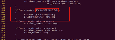

hi,
I made a try on imX6Q Linux4.1.15 version,Rotate the screen 180 degrees. use  command echo 1 > /sys/class/graphics/fb0/rotate  .But the display is abnormal,Not only up and down, but also left and right.It's very confusing.So I tried to find the problem in the driver .I have found
drivers/video/fbdev/mxc/mxc_ipuv3_fb.c  A corresponding parameter is passed 。I can't find the corresponding call ,but I can't find the corresponding calls and modifications that make it upside down, not left to right
Thank you for your help!

@Juan-Rodarte
    There is no good solution?
thank you for your help!

joanxie
this couldn't be supported, you can use GPU2D to support rotation

小李
hi,@joanxie
    Is there any way to rotate 180 degrees? Is there any specific modification routine

joanxie
refer to the chapter  7.3.14 Video conversion of enclosed file

小李
hi,@joanxie
    What I want to do is display rotation of the screen, not play video rotation, do you have any other suggestions

joanxie
pls refer to the chapter 6.2 XRandR of enclosed file
