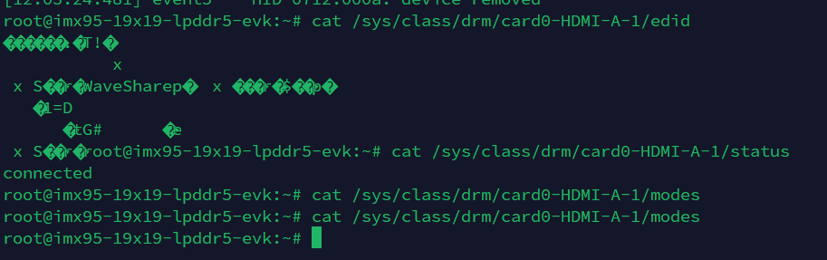

Since we are using an HMI-LVDS-HDMI adapter, we managed to redirect output to our standard HDMI display's full HD resolution by using a combination of dtb (imx95-19x19-evk-it6263-lvds-dual.dtb) and overlay (imx95-19x19-evk-it6263-lvds-dual.dtbo) instead of the default one.
However, when we plugged in our use-case-based HDMI display resolution of 1920x720, we had a failure in our driver (picture will be added), and also a failure in the Weston service (log will be provided).
This suggests to me that maybe some custom resolutions are not supported by default. Could you provide us with directions on what we should look into, or maybe where the changes should be made?image.png

[12:03:24.471] no available modes for HDMI-A-1 (this is related to the picture above)
[12:03:24.471] Cannot configure an output using weston_drm_output_api.
