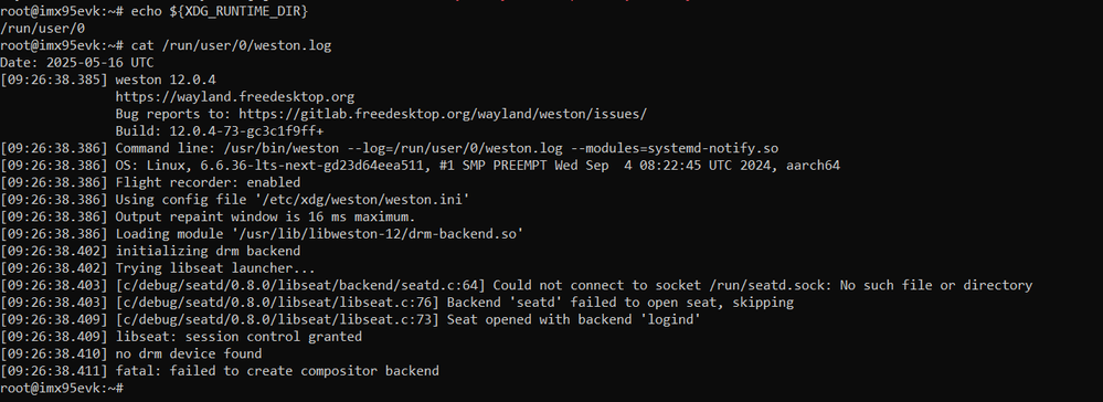

Hello everyone,
We have successfully built and flashed a Yocto image for the NXP i.MX95LPD5EVK-19CM board. According to the Quick Start Guide, the display should be connected via the J14 MIPI-DSI connector using the IMX-MIPI-HDMI adapter. However, we currently only have access to the IMX-LVDS-HDMI adapter, which we previously used with the NXP i.MX8 platform.
We noticed that the i.MX95 board includes two LVDS connectors. We attempted to connect our display using both, but the board does not appear to recognize the connected monitor. (We’ve attached photos for reference.)
Our main question is:
Does the i.MX95 board supports LVDS display output, or is this functionality possibly disabled in the current device tree configuration? Alternatively, is MIPI the only supported display interface for this board, requiring us to obtain the IMX-MIPI-HDMI adapter?
Any guidance or clarification would be greatly appreciated.

Here are some additional logs from dmesg:
root@imx95evk:~# dmesg -w | grep drm
[    2.977422] [drm:drm_bridge_attach] *ERROR* failed to attach bridge /soc/dsi@4acf0000 to encoder None-39: -19
[    2.987370] [drm:drm_bridge_attach] *ERROR* failed to attach bridge /soc/syscon@4b010000/bridge@8/ports/port@0 to encoder None-39: -19
[    3.006505] [drm:drm_bridge_attach] *ERROR* failed to attach bridge /soc/bridge@4b0d0000/channel@0 to encoder None-39: -19
[    3.006520] imx95-dpu 4b400000.display-controller: [drm] *ERROR* failed to attach bridge to encoder for stream0: -19

Bio_TICFSL
Some modification in the dtb are needed to have LVDS working on MX95, however the latest linux BSP included it on it , please check it.
Your fails is more like missing GPU,  please use the full-image in yocto and see whats happens.
