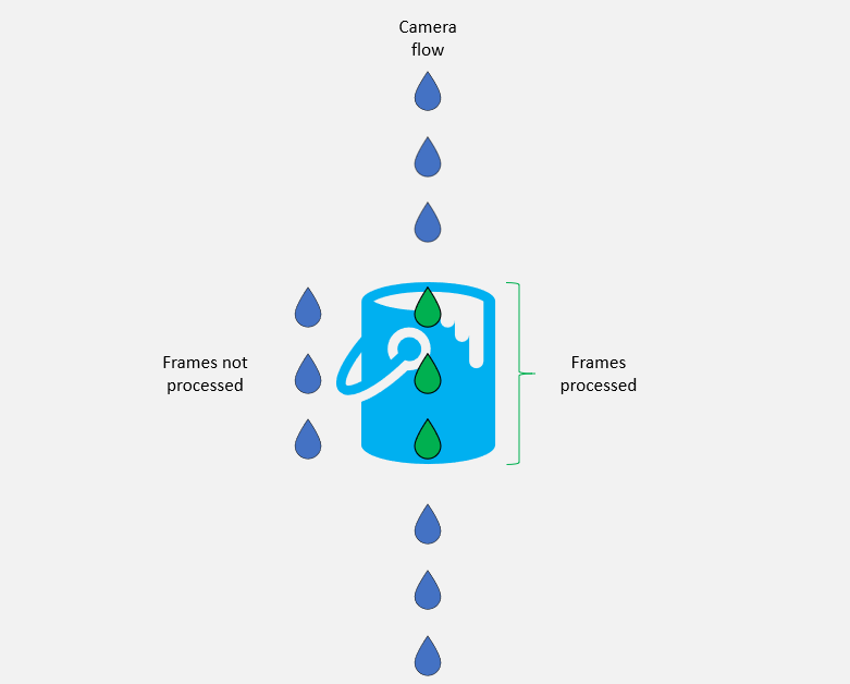

3 - OpenCV DNN example: MIPI Camera improved
This example differs from the above due the additional support of GStreamer applied to it. Using the Leaky Bucket algorithm idea, the GStreamer pipeline enables the camera to continue performing its own thread (bucket overflow when full), even if the frame was not processed by the inference thread (bucket water capacity).
As a result of this Leaky Bucket algorithm, this demo has smooth camera video at the expense of having some frames dropped in the inference process.
root@imx8mmevk:/opt/opencv# ./camera_improved.py
