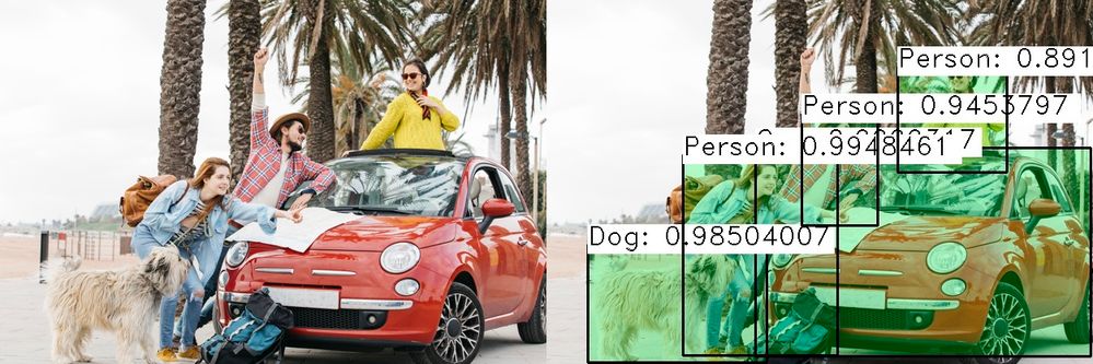

This example runs a single picture for example, but you pass as many pictures as you want and save them inside media/ folder. The application tries to recognize all the objects in the picture.
Step 1 - For copying new images to the media/ folder:
root@imx8mmevk:/opt/opencv/media# cp <path_to_image> .
Step 2 - Run the example image:
root@imx8mmevk:/opt/opencv# ./file.py
 NOTE: If GPU is available, the example shows: [INFO:0] Initialize OpenCL runtime
This demo runs the inference using a Caffe model to recognize a few type of objects for all the images inside the media/ folder. It includes labels for each recognized object in the input images. The processed images are available in the media-labeled/ folder. See before and after labeling:
Step 3 - Display the labeled image with the following line:
root@imx8mmevk:/opt/opencv/media-labeled# gst-launch-1.0 filesrc location=<image> ! jpegdec ! imagefreeze ! autovideosink
