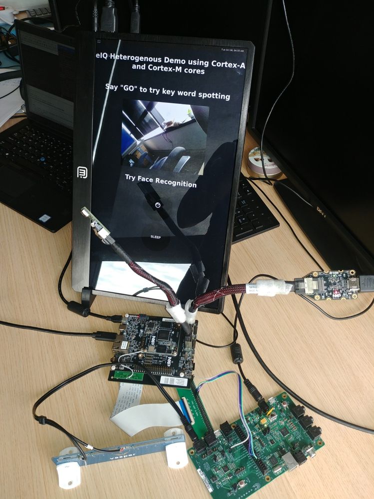

This demo shows a low power smart door running eIQ heterogeneously on i.MX8MMini:
The demo application is build around the Django framework running on the board. It has two main usage scenarios:
  • The first one is to manage users and inspect the access logs through a dashboard. This dashboard is accesses from a web browser on the host PC.
  • The second use case is the smart door application itself running on the board. The scenario is the following: Cortex A cores and connected peripherals stay in low power mode. Cortex M is active, waiting for the Key Word ‘GO’. When the word is detected, Cortex M sends an MU interrupt to Cortex A and the system wakes up. Now Cortex A performs face recognition and allows access for registered users.
In addition to face recognition, the MPUs are able to run a Django server to manage the user’s database, a QT5 application for the graphical interface and perform training on the edge.
The algorithm for face recognition running on Cortex A and the one for key word spotting running on Cortex M are both implemented using eIQ. For the MPU eIQ support is integrated in Yocto. For the MCU the support was ported to i.MX8 from the MCU Expresso SDK for RT for the purpose of this demo.

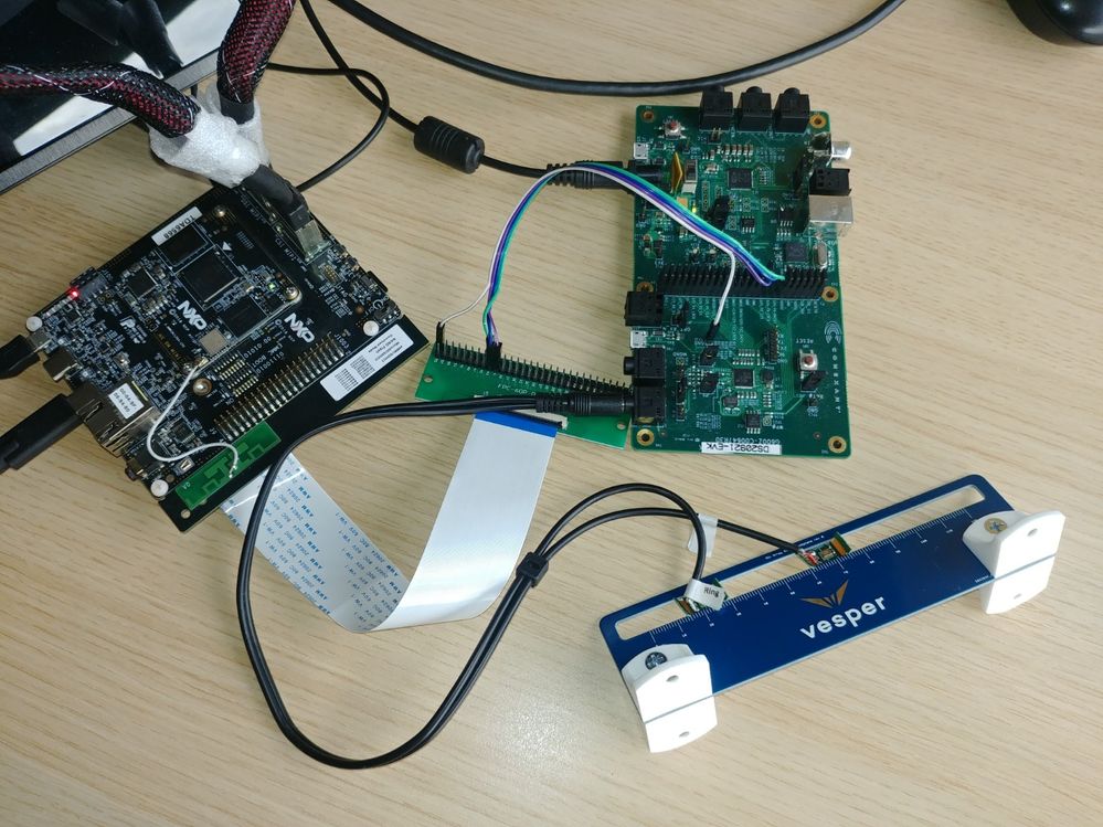

  • i.MX 8MMini Kit
  • Touch screen display (preferred resolution 1920x1080). Tested with HDMI connection to the board.
    NOTE: if the display does not support touch, a mouse can be connected to the board and used instead
  • MIPI-CSI Camera module
  • Microphone: Synaptics CONEXANT AudioSmart® DS20921
  • Ribbon, 4 female-female wires and 60 pins connector to connect mic to board
  • Optional: headphones (used to test recording on M4 - everything recorded by the mic will be played to the headphones).
  • Host PC for remote access to the demo application (used Chrome browser)
NOTE: The board and the host PC should be in the same network to communicate.

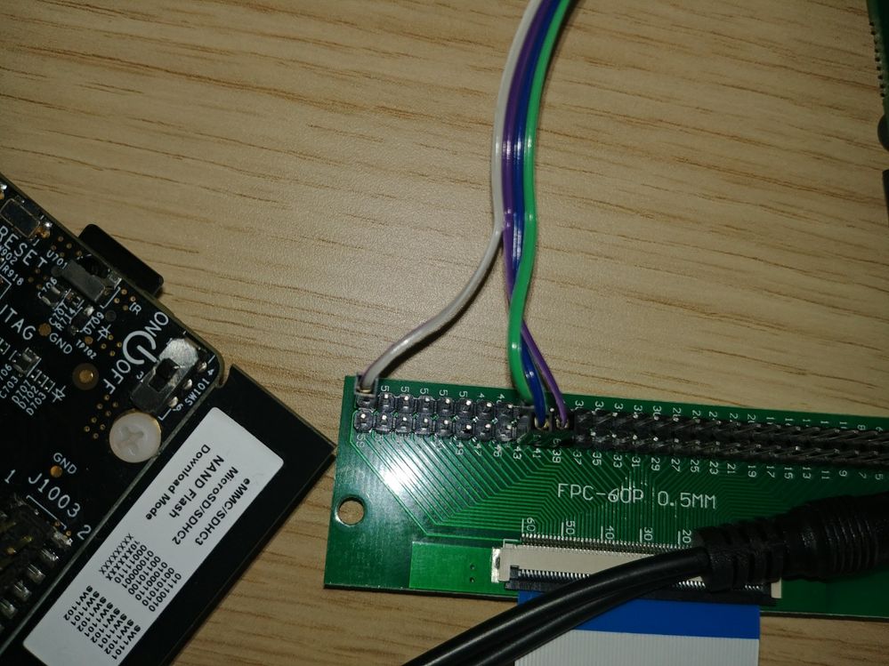

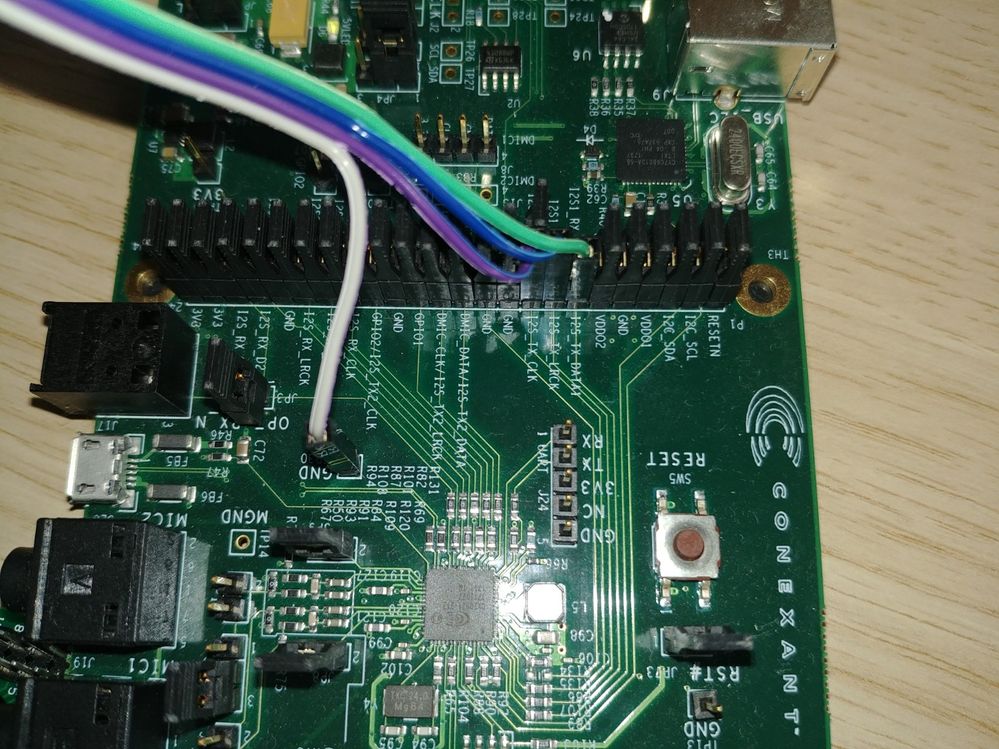

6. Connect Synaptics microphone to the board using a 60 pins connector with a ribbon. SAI3 is used for record and playback on Cortex M4. The following pins are used:
  • Pin 44 (connector) <-> I2S_TX_Data1 (mic board)
  • Pin 43 (connector) <-> I2S_TX_LRCLK (mic board)
  • Pin 41 (connector) <-> I2S_TX_CLK (mic board)
  • Pin 60 (connector) <-> GND (mic board)

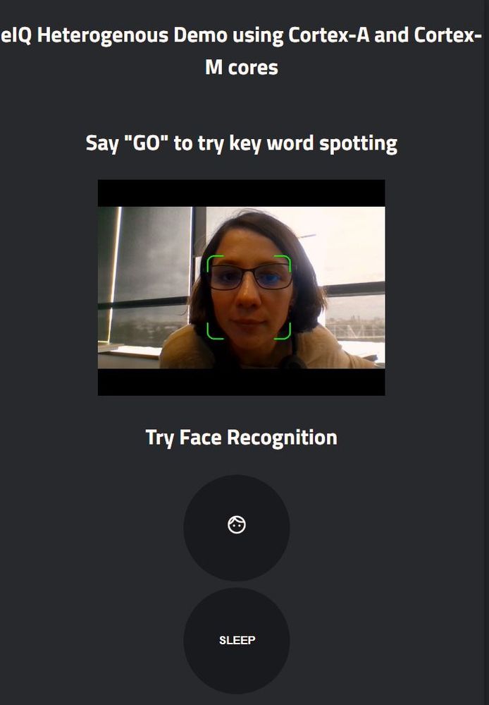

$: python3 manage.py runserver 0.0.0.0:8000 --noreload &
$: /opt/src/bin/src
NOTE: the first instruction will start the django server, the second instruction will show the pin-pad on the display.

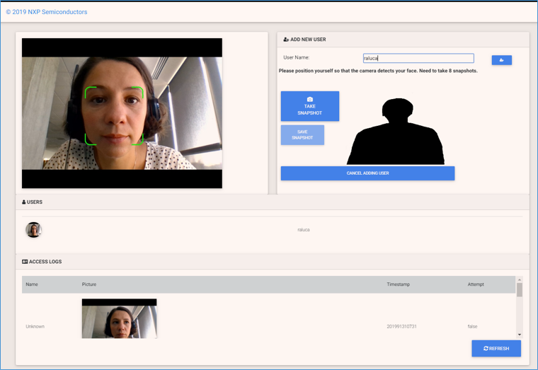

Browser access from HOST PC:
- http://$BOARD_IP:8000/dashboard/ Dashboard that facilitates managing users and view access logs
- http://$BOARD_IP:8000/admin/: manage users database
