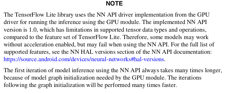

We have the need to use python 3 bindings and Keras (either Keras or tf.keras) as the front end for TensorFlow and TensorFlow Lite on i.MX8QuadXPlus. From the i.MX Linux Release Notes (L4.19.35) I can see that Hardware Accelerated eIQ Machine Learning is supported on this SoC, however, there are no further details on what features are supported for each framework (TF, TF-lite, OpenCV) and on what version. There is also no mention of the Python bindings for TF or TF-lite, are these available? On what version (2.7, <=3.6 or >=3.7)?
Is there up to date documentation regarding the supported features for each SoC?

Hi Jose,
In L4.19.35 TfLite supports running inference on GPU:
From Release Notes, 8QXP supports this NN acceleration:
Keras is currently not supported.
Python3 bindings for TfLite and ArmNN will be available in future releases.
Vanessa

vanessamaegima‌ Thank you very much for your detailed response. Is there an expected release date for python 3 bindings? Do you know what version of python 3 will be used (<=3.7)?
Thank you

vanessa_maegima
Next release will be available by the end of this month, March 31st.
Internal image at this point uses Python 3.7.
