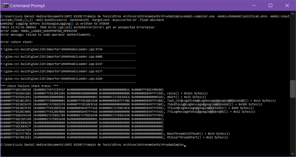

Thanks for the insight, I was able to modify the model to always use tensors of the same size and it solved the issue of the missing constant, but also revealed another issue which has to do with the "GatherElements" operation in the ONNX model. Now when I run the command to compile the model, I get an error that reads "Error Code: MODEL_LOADER_USUPPORTED_OPERATOR" and "Error Message: Failed to load operator GatherElements".
According to https://github.com/pytorch/glow/pull/5285, this should no longer be a problem, since support for such operator was added since May 10th of this year. Any ideas on what could be the issue?

Hello @LuisMedina-08,
the GLOW in our SDK is based on a late June release, however, the pull request you linked to adds only partial support for the operator:
  1. it's adding support specifically to the torch.gather operator
  2. it's adding support for the interpreter backend of GLOW, whereas we use the CPU backend of GLOW instead
Could you try replacing the GatherElements with a different Gather operator, like Gather or GatherND or would that not work?
David

LuisMedina-08
Unfortunately I can't change the exact Gather operator the ONNX model implements, as it is chosen by Pythorch during the translation of the original model to the ONNX format. In view of this I assume the only option is to wait for further updates of the GLOW compiler to eventually add compatibility with such operator. Thanks for the support.

david_piskula
I see, in that case, yeah, you will have to wait until support for this operator is implemented. Perhaps you could raise the issue on GitHub and let them know that there is a need for this operator so that they might decide to prioritize it over others.
Good luck,
