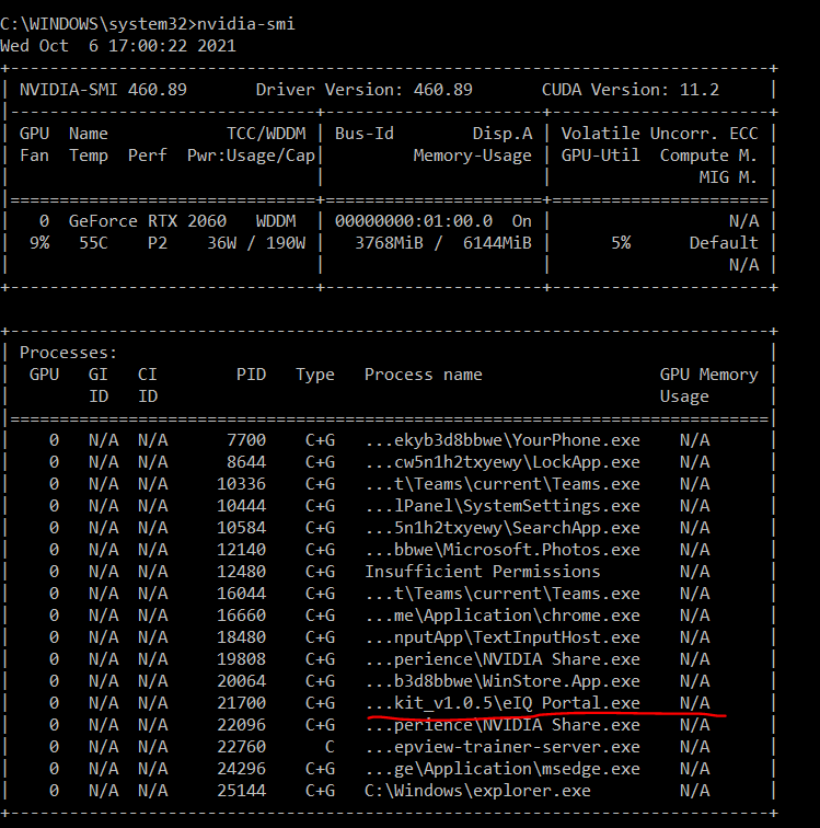

I am new to eIQ Portal and wondering what kind of cudnn/Tensorflow version etc. must be pre installed or if they are delivered with the program itself.
When launching the eIQ Portal.exe I am getting the following hints:

Which obviously detects the GPU [Geforce RTX 2080 Ti] - however it fails to register the cudnn files. Do I need to install them, and if so which one?

@khoefleYou will need to install v7.x of the cuDNN that corresponds to your Cuda Driver.  You can download them from the cuDNN archive page (Nvidia Developer login is required I believe).  Here are the instructions on how to install cuDNN. I wasn't able to run cuDNN v8.x, it looks like eIQ portal requires v7.x (cudnn64_7.dll file).  On the achieve page v7.x goes up to Cuda v10.2.  So if you have a later driver, you may need to uninstall and install an older one.

Hello @khoefle ,
the Cuda driver version depends on the TensorFlow version supported by eIQ Portal. In the currently released eIQ Portal, the TensorFlow version is 2.3.2.
Please try installing the v7.6 cuDNN and CUDA 10.2, as @mgandhi mentioned.

khoefle
Hey @Ramson
You do not need to build it from source, it is perfectly fine to do the "official" way as documented by NVIDIA.
To locate the the problem a good way is to start eiQPortal.exe from the command line  - it will output a lot of information on whats missing and which dlls etc. cannot be loaded

Ramson
Hi @khoefle , when running in command line, These are the output .Do you find any issues in this? Please let me know
C:\nxp\eIQ_Toolkit_v1.0.5>"eIQ Portal.exe" C:\nxp\eIQ_Toolkit_v1.0.5> NXP eIQ Portal version 2.1.30 Launch ->

khoefle
I do not see any issues here, it looks roughly the same as mine. I can only tell you that the line:
 [CONVERTER] 2021-10-06 12:56:45.422699: E tensorflow/stream_executor/cuda/cuda_driver.cc:314] failed call to cuInit: CUDA_ERROR_NO_DEVICE: no CUDA-capable device is detected
IS NOT A PROBLEM.
I have the same GPU and it utlizes the GPU, you can use nvidia-smi to check if the GPU is utlized.

Ramson
Hi @khoefle ,
Thanks for the help. when given nvidia-smi command I get the following output. Two things worries me is that. First is, the cuda version is showing as 11.2, but i have uninstalled it and installed 10.2 already. Second, the GPU memory usage shows N/A.
I get the following output when i gave help for nvidia-smi :
"used_gpu_memory" or "used_memory"
Amount memory used on the device by the context. Not available on Windows when running in WDDM mode because Windows KMD manages all the memory not NVIDIA driver.

khoefle
From this point on I can only guess, but maybe check if your CUDA_PATH etc. is set correctly, sorry for not being able to help you further
