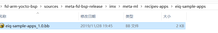

Hi coindu‌,
Could you please confirm that the patch was successfully applied? Does the eiq-sample-apps folder exists in meta-fsl-bsp-release/imx/meta-ml/recipes-apps/eiq-sample-apps? What BSP release are you using?
Thanks!
Vanessa
fsl-arm-yocto-bsp/sources/meta-fsl-bsp-release$ git log
commit 7a67a5a9f8bb31a50bf6704d6383957c8264c656
Author: Vanessa Maegima <vanessa.maegima@nxp.com>
Date: Tue Oct 1 16:07:22 2019 -0300
eiq-sample-apps: Add recipe
Recipe to deploy all eiq_sample_apps to an iMX8* board.
Signed-off-by: Vanessa Maegima <vanessa.maegima@nxp.com>
commit 8eeb420fad668b733ab95b460895e1c337c66b25
Author: Neena Busireddy <neenareddy.busireddy@nxp.com>
Date: Fri May 3 10:50:12 2019 -0500
vkmark: Use SHA in SRCREV instead of AUTOREV
Signed-off-by: Neena Busireddy <neenareddy.busireddy@nxp.com>
I reference 《UM11226.pdf》 to set the environment
repo init -u https://source.codeaurora.org/external/imx/imx-manifest -b imx-linux-sumo -m imx-4.14.98-2.0.0_machinelearning.xml
$: EULA=1 MACHINE=imx8mqevk DISTRO=fsl-imx-xwayland source ./fsl-setup-release.sh -b build-xwayland $: echo "BBLAYERS += \" \${BSPDIR}/sources/meta-imx-machinelearning \"" >> conf/bblayers.conf
meta-imx-machinelearning/recipes-libraries/tensorflow/tensorflow_1.12.0.bb  modify
COMPATIBLE_MACHINE = "(imx8qm|imx8mq|imx8mm)"
bitbake fsl-image-qt5
Could you please modify the COMPATIBLE_MACHINE in the eiq_sample_apps recipe as you did for TensorFlow and let me know how it goes?
My patch applies on top of a newer release L4.19.35 but let's try to make this work on L4.14.98
It do not work to modify COMPATIBLE_MACHINE.
It doesn't matter, I still compile according to the documentation
