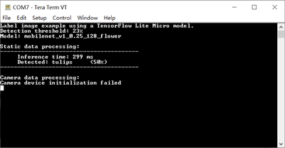

I try to follow this tutorial: Getting Started with TensorFlow Lite for Microcontrollers on i.MX RT to deploy flowers classification model in i.MX RT1050-EVKB. I test the generated .tflite model following the tutorial, and get correct inference result. But I can not get correct inference result after converted .tflite to .h with xxd, and deploy it in i.MX RT1050-EVKB.

Hello @lixianghan,
thank you for your interest in eIQ. Could you please try converting your flower image with the following python script instead of xxd?:
    import cv2
    import numpy as np
    img = cv2.imread('flower.bmp')
    img = cv2.resize(img, (128, 128))
    img = cv2.cvtColor(img, cv2.COLOR_BGR2RGB)
    with open('image_data.h', 'w') as fout:
      print('static const uint8_t image_data[] = {', file=fout)
      img.tofile(fout, ', ', '0x%02X')
      print('}\n', file=fout)

lixianghan
Thank you for your help! I solved this problem.
The correct python script:
import cv2
import numpy as np
img = cv2.imread('daisy.bmp')
with open('daisy.h', 'w') as fout:
    print('#define STATIC_IMAGE_NAME "daisy"', file=fout)
    print('const char daisy_bmp[] = {', file=fout)
    print('};\n', file=fout)
The ; in the last is important.
