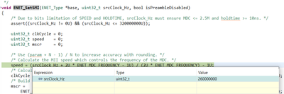

It seems that in MCUxpresso sample 260 MHz frequency is being used to calculate MSCR register values:
2,154 次查看
Maciej_Jj
No problem, I've flashed frdmrw612_enet_txrx_transfer sample using MCUXpresso IDE 24.9.25 and here everything seems to work fine, measured frequency on MDC pin is 2.5 MHz
