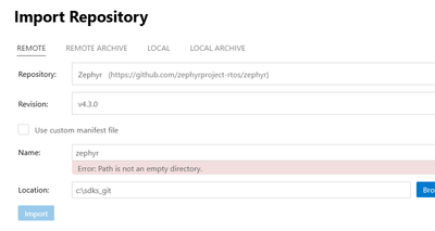

Hi, developer in training here! I'm trying to work with MCUXpresso in VSCode and Zephyr 4.3.0. I have been trying to import an example from the Zephyr repository for the FRDM-IMX93, "synchronization" or "hello world", but when I try to build them a "Error: could not find CMAKE_PROJECT_NAME in Cache" pops up. I have done some very-simple work with the MIMXRT1060-EVKB and MIMXRT1160-EVK with the same set-up with no problem, and the projects build just fine.  I'm not sure if I'm missing something, as I'm still trying to learns the basics of Zephyr...

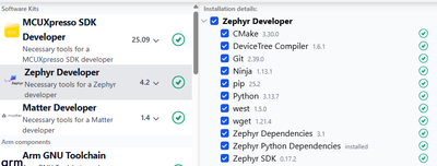

Hi, I installed the tools following the Zephyr https://github.com/nxp-mcuxpresso/vscode-for-mcux/wiki/Zephyr-Lab-Installation-and-Preparation guidelines. I suspect that maybe it has something to do with the versions of the tools (I attach a photo of the currents versions), as the FRDM-IMX93 is a relatively "new" incorporation, and only supported via MCUXpresso in Zephyr v4.3.0. With the other dev-kits I can compile and develop my projects without problems.

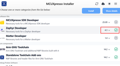

Hi @Zhiming_Liu ! I have updated the installation, and now have the v4.3 for the Zephyr Developer. However the problem is still there...
I have revised the logs, and I think the problem originates in the Zephyr SDK:
Cmake Error at:
/mnt/.../.../zephyr/zephyr/zephyr/cmake/compiler/gcc/target.cmake:11 (message):
C compiler:
/home/.../zephyr-sdk-0.17.4/aarch64-zephyr-elf/bin/aarch64-zephyr-elf-gcc not found - Please chek your toolchain installation.
However, my zephyr-sdk-0.17.4 folder has no <aarch64-zephyr-elf> subdirectory, but <arm-zephyr-eabi> instead. Could that be it?
418 次查看
Zhiming_Liu
Hi @jaseze01
yes, the complete installation of sdk should contain aarch64-zephyr-elf folder,you can try to delete zephyr-sdk-0.17.4 folder and reinstall it.
Zhiming
