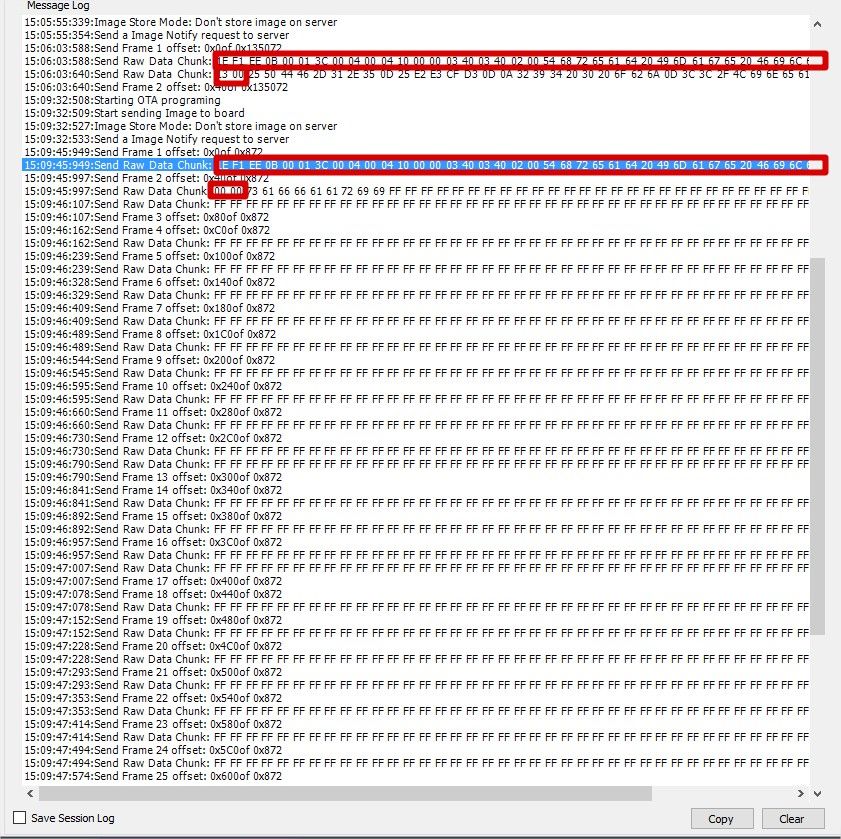

i am trying to push an xml file from end device to router eligible device. Is it a good idea? should i fragment the data ?

Yes, Test Tool breaks the file into fragments. Take a look at the following screenshot:
What I've highlighted are the initial bytes that were send when I've initiated the transfer of two different files. The first one was too large for Test Tool (1.2 MB) and broke after the two chunks sent, and the second successfully sent the file with, by adding FF padding to multiple of 1 KB I believe.
Observations:
  • Test Tool OTA transfer was not created for regular file transfers; for example it doesn't work for big files (at 1.2 MB it cracked for me)
  • you should transmit the size beforehand so that you would know how many bytes you will need: it seems that first 66 bytes (first chunk and 2 bytes from chunk 2) are filled with information about image
  • don't forget to add the OTA bootloader on the client (even though you will not use it to rewrite the image, it seems that it OTA client isn't working without it);btldr.jpg
  • after I gave some thought to OTA transfer, I came to the conclusion that the other approach, with CoAP messages exchange, is better; even though there is more work to do, you can control exactly how you want to send the file;

Hello Lillian,
Please look at the image below
I have generated a .bin out of my .xml and started OTA with out looking at the register address which has crashed the client as expected. I think i can flash it with original.
Is there any information about setting up new register address ? can Test tool help in modifying that ?
if it is possible, how do i read the transferred data on the client side ?

What you encountered is not a matter of Test Tool configuration, but of the application you have on the client. What happened is that you didn't instruct the application what to do with the received chunk. By default, as mentioned in my previous comment, the function called for the chunk is "OTA_PushImageChunk", which does the following: "Places the next image chunk into the external FLASH. The CRC will not be computed." (extracted from its description). Here is where you add your function that will send on serial line the chunk to the computer.
