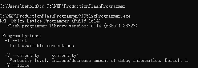

I'm new join the NXP product family development .I am confused so much flash programmer,
1. The named JN-SW-4107.zip default installation C:\NXP\ProductionFlashProgrammer\JN51xxProgrammer.exe,this is a CLI(command line interface) program:

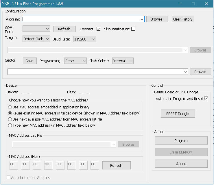

2.The named 'NXP JN51xx Flash programmer 1.8.9' is following capture,this can be download from website link http://www.zlg.cn/data/upload/software/Wireless/flashprogrammer.zip,this program user interface may be batter friendly than the "BeyondStudio for JN51xx attachment plugins" GUI flash programmer
the user interface:

Hi Behold,
Both software is used for loading built applications into JN51xx Flash memory.
I recommend the JN-SW-4107, The Production flash programmer, the user interface is no longer supported.
Mario
