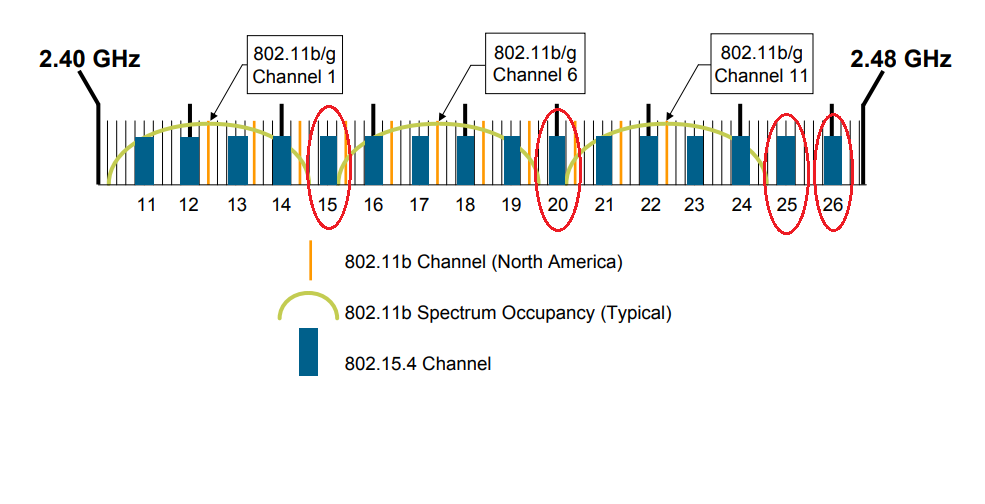

When the coordinator started with ZPS_eAplZdoStartStack () in some circumstances , It meets stack event ZPS_EVENT_NWK_FAILED_TO_START.
That circumstances is several WiFi routers around.
If I turned off several WiFi routers around, ZPS_EVENT_NWK_STARTED is generated.
Is there a good solution without turning off the WiFi router around?

I suggest you to switch you application to channels where is not overlapped with typical Wi-Fi spectrum. Hopefully, this will make your network can co-exists even though you have several Wi-Fi routers around.
802.15.4 open channels when Wi-Fi fully utilized the band: 15, 20, 25 and 26.

I have tested but that channel is sometimes occurs  event ZPS_EVENT_NWK_FAILED_TO_START.
Is it possible to set the channel manually if an event occurs ZPS_EVENT_NWK_FAILED_TO_START?

Yes, it is possible to change your network channel. You can configure that in bdb_options.h.

In Home Automation SDK you can look in JN-AN-1184 Router example. Using that AN you can change the channel in  app_router.c file and vStartup function.
