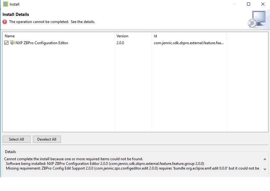

i have a problem to install the plugin Zbee pro configuration editor
with sdk JN-4170
the version of beyond studio  is : Build 1308
sdk jn 4170 is : Build Number 1745
when i install the plugin (ZB pro configuration edition 2.0.0), i have the message error :
"Cannot complete the install because one or more required items could not be found.
Software being installed: NXP ZBPro Configuration Editor 2.0.0 (com.jennic.sdk.zbpro.external.feature.feature.group 2.0.0)
Missing requirement: ZBPro Config Edit Support 2.0.0 (com.jennic.zps.configeditor.edit 2.0.0) requires 'bundle org.eclipse.emf.edit 0.0.0' but it could not be found
Cannot satisfy dependency:
From: NXP ZBPro Configuration Editor 2.0.0 (com.jennic.sdk.zbpro.external.feature.feature.group 2.0.0)
To: com.jennic.zps.configeditor.edit [2.0.0]"

Hi Yann,
Could you please uninstall the Beyond Studio and the SDK again?
Mario

cyder_shot
The final problem was internet resource invalid caused beyond studio install ZBpro plugins failure.
Becaused eclipse IDE package architecture changed,the following resource unreachable
http://download.eclipse.org/releases/kepler/content.jar
http://download.eclipse.org/releases/kepler/content.xml
We should download and install manually.
1. remove all Available Software Sites at Help-> Install New Software-> "Available Software Sites"
2. download and install CDT
https://www.eclipse.org/downloads/download.php?file=/tools/cdt/releases/kepler/sr2/cdt-master-8.3.0....
3. Only need install "EMF Compare Core" plugin
4. install ZBPro plugins with yourself way.

mario_castaneda
Hi Yann,
Just to confirm. Are you using the next path for the plugins?
Could you please try this path?
\NXP\bstudio_nxp\sdk\JN-SW-4170\Tools\Eclipse_plugins\com.nxp.sdk.update_site
Please let me know if you still have this issue. Could you please provide a screen of the issue?
Mario
