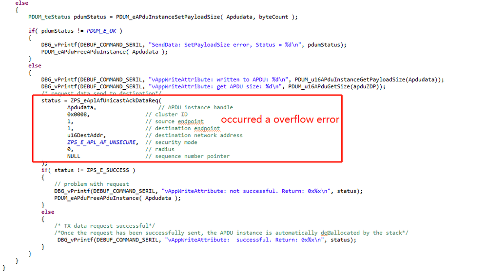

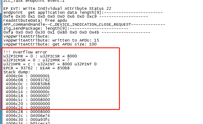

Hi, I have a problem about overflow error!
There are two device(A and B) communication each other, process steps as below:
1. A send a packet to B;
2. B read the data and reply a packet to A;
3. B occurred a overflow error when reply a packet;
This is the send or reply packet data code:

   status = ZPS_eAplAfUnicastAckDataReq(
   Apdudata, // APDU instance handle
   0x0008, // cluster ID
   1, // source endpoint
   1, // destination endpoint
   u16DestAddr, // destination network address
   ZPS_E_APL_AF_UNSECURE, // security mode
   0, // radius
   NULL // sequence number pointer
if( status != ZPS_E_SUCCESS )
   // problem with request
   DBG_vPrintf(DEBUF_COMMAND_SERIL, "vAppWriteAttribute: not successful. Return: 0x%x\n", status);
   PDUM_eAPduFreeAPduInstance( Apdudata );
else
   /* TX data request successful*/
   /*Once the request has been successfully sent, the APDU instance is automatically deallocated by the stack*/
   DBG_vPrintf(DEBUF_COMMAND_SERIL, "vAppWriteAttribute: successful. Return: 0x%x\n", status);
This is the read packet data code:
PUBLIC void readAttbuteData(tsZCL_CallBackEvent *psEvent, uint8 *packData, uint8_t *Len)
uint8 au8LinkTxBuffer[256];
uint16 u16Length = 0;
uint8* dataPtr;
uint8 u8Size;
uint8 i = 0;
dataPtr = ( uint8* ) PDUM_pvAPduInstanceGetPayload ( psEvent->pZPSevent->uEvent.sApsDataIndEvent.hAPduInst );
u8Size = PDUM_u16APduInstanceGetPayloadSize ( psEvent->pZPSevent->uEvent.sApsDataIndEvent.hAPduInst );
while (i < u8Size)
   ZNC_BUF_U8_UPD( &au8LinkTxBuffer [u16Length], dataPtr[ i ], u16Length );
   i++;
DBG_vPrintf(TRUE, "endpoint get application data length[%d]:------------------------\n",u16Length-6);
for(i=0; i<u16Length-6; i++){
   DBG_vPrintf(TRUE, "0x%x ",au8LinkTxBuffer[i+6]);
   DBG_vPrintf(TRUE, "--------------------\n");
memcpy(packData,&au8LinkTxBuffer[6],u16Length-6);
*Len = u16Length-6;
//Once the response has been dealt with, the application must de-allocate the APDU instance using the function PDUM_eAPduFreeAPduInstance()
if (psEvent->pZPSevent->uEvent.sApsDataIndEvent.hAPduInst != NULL )
   DBG_vPrintf(TRUE, "readAttbuteData: free apdu\n");
   PDUM_eAPduFreeAPduInstance(psEvent->pZPSevent->uEvent.sApsDataIndEvent.hAPduInst);

Hi Dylan,
How long is the data that you are sending?
Do you have a lot of PDUM_u16APduInstanceWriteNBO? Is it works when you sent this by the A device?
What is the AN that you take as reference?
Mario
